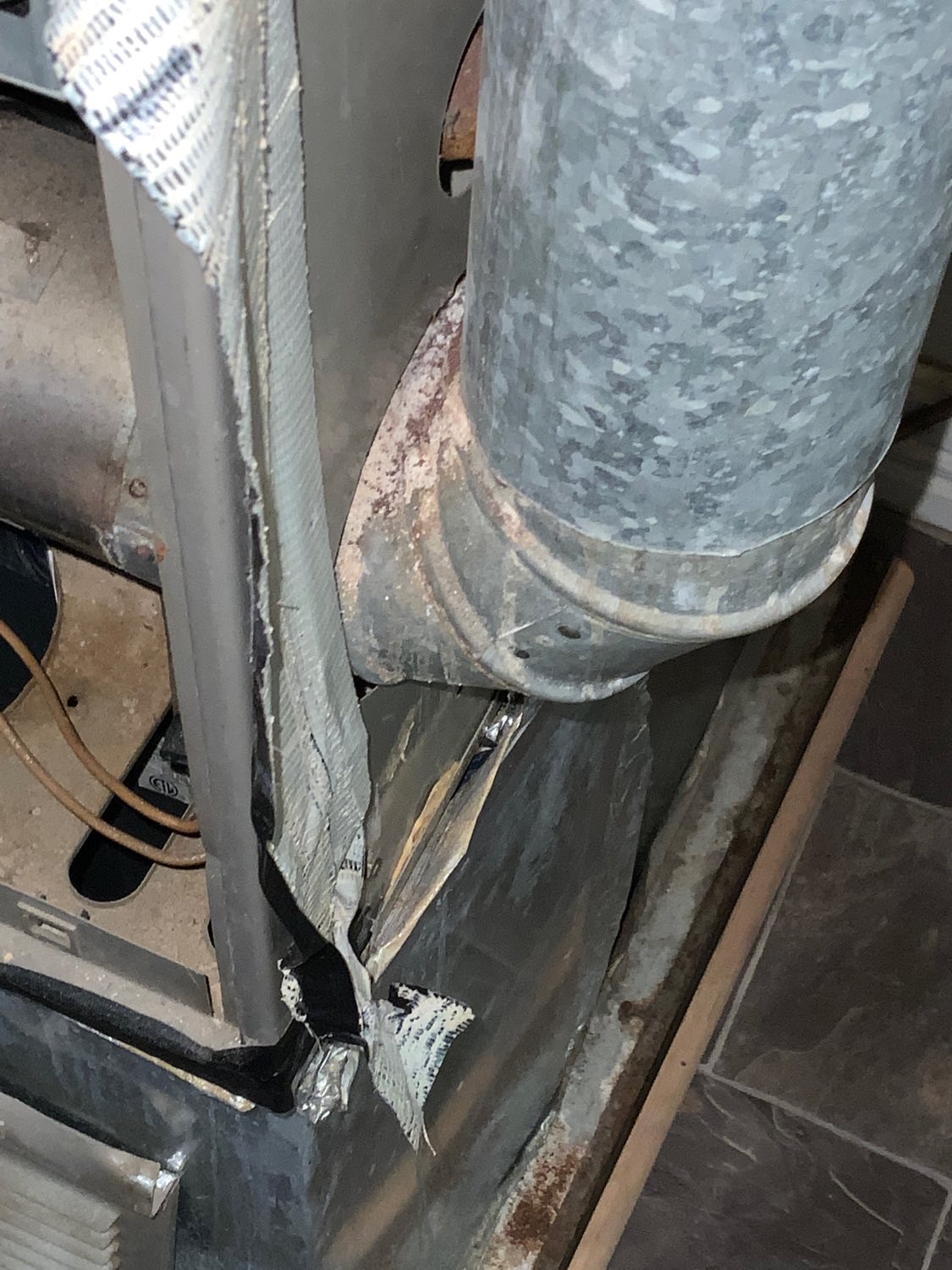

What exactly is this white powder on the furnace vent? It is combustion by product? There was an opening where a rivet or screw went. Some staining around tape. Didn’t see any signs of rusting or damage elsewhere. 1999 goodman furnace.
This might be it
Awesome! Thanks a lot Brian
I once heard it’s a reaction between the zinc on the galvanized steel vent and sulfur which is inherent to natural gas (and increasing due to less pure fuel). This seems to go along with what Brian’s link says.
I have noticed it can be a sign of poor venting if there is an excessive amount. I don’t specifically comment if/when I see it but it can trigger me to start looking more closely at the overall setup when excessive.
The furnace needs to be serviced and checked with combustion analyzer for proper/clean firing. Too often the gas equipment is left unattended without any service and or inspection for years. 20+ years for a gas equipment is a decent lifespan. Hope the vent had proper rain cap.
There was indeed a rain cap.
Its zinc oxide likey due to a venting problem. I would definetly write it up as being in need of further evaluation by an HVAC specialist.
