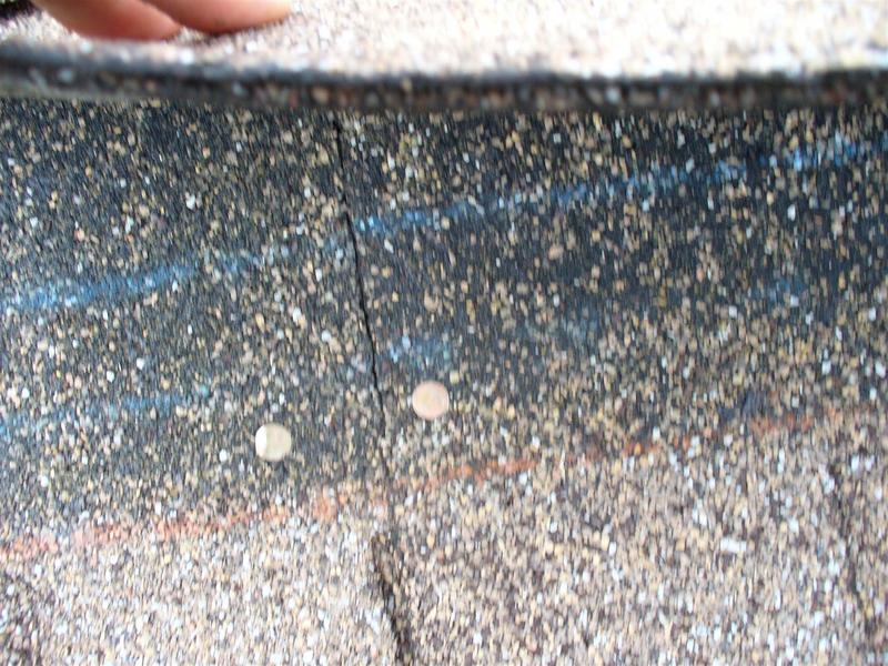

So now, here is a question for you?
The house has been re-roofed in 2008. There is no product approval available but, there is a closed permit. So therefore, it must meet the FBC, right?
See the pictures below and tell me emphatically that it meets the FBC…or any other code for that matter. What do you mark on the form?

As to your shutter question, the picture of no hardware will end the discussion and answer the question. Obviously not and since whatever method you choose, if it cannot be attached, it won’t count and according to the form, you have to mark undetermined. I don’t know if you get a credit, nor do I care.
Getting back to the original question, the form asks for proof, that proof, according to the form, is the permit application date. If the insurance company decides to pursue it further, I know my clients will have been forewarned.
