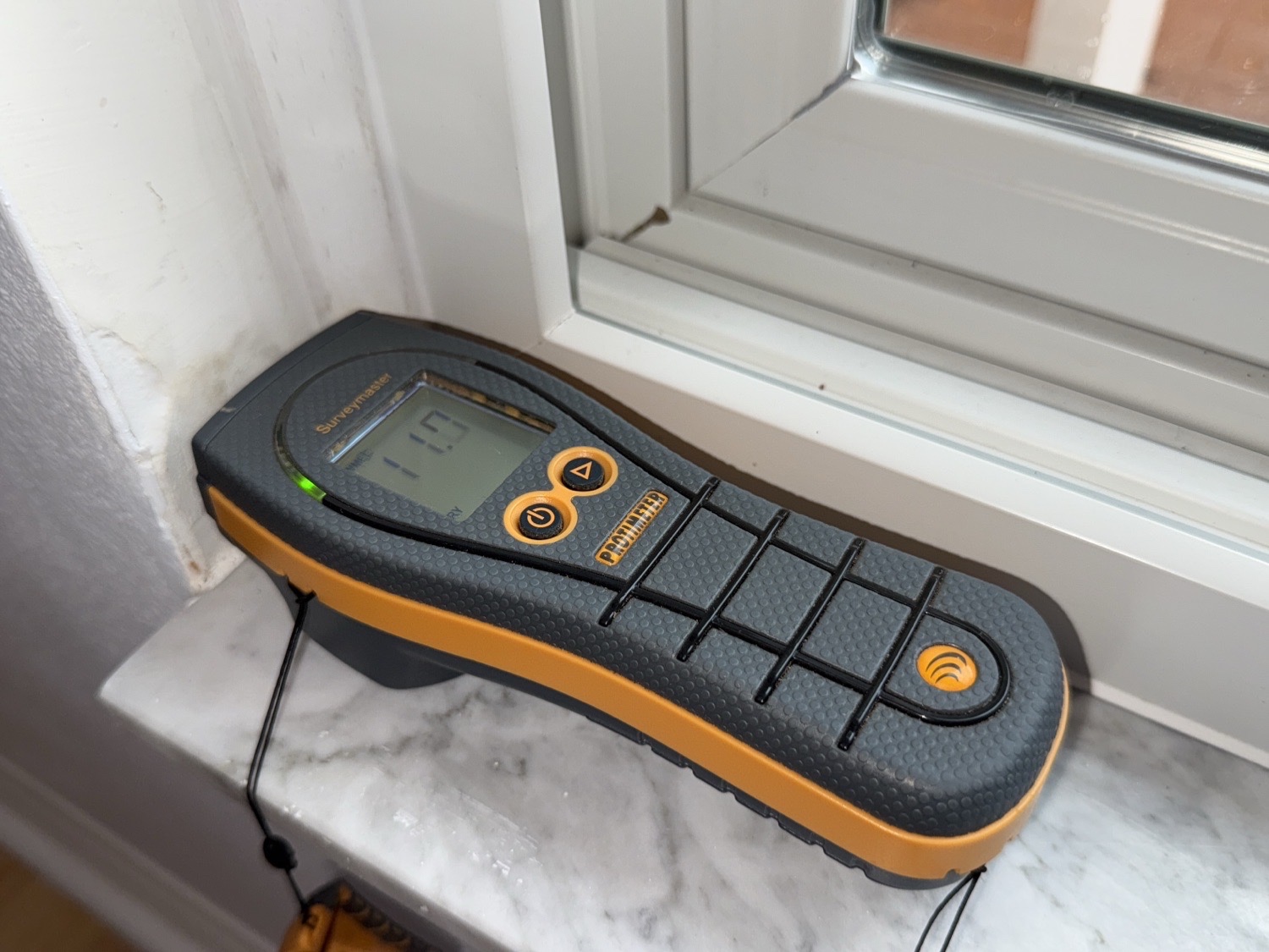

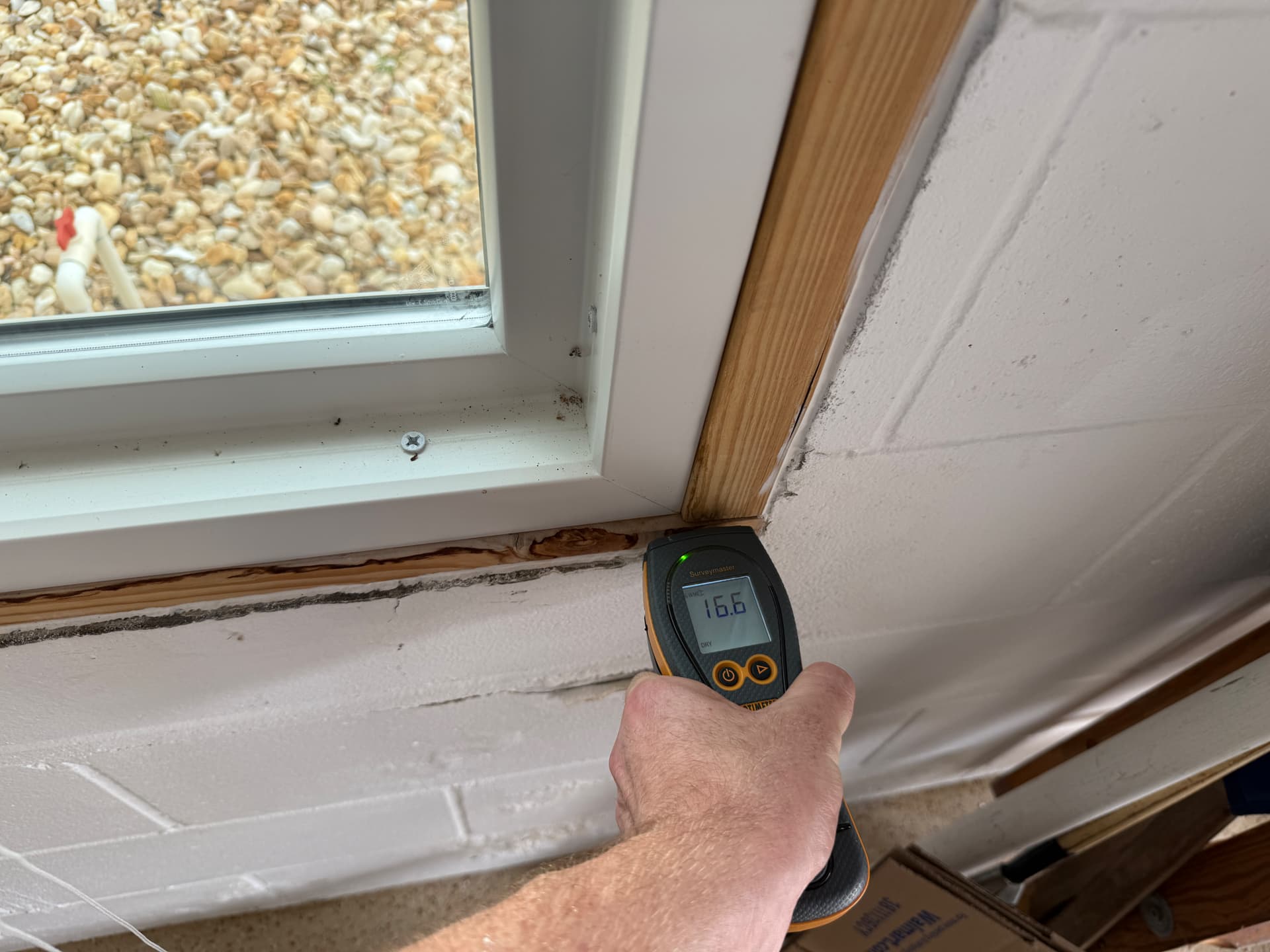

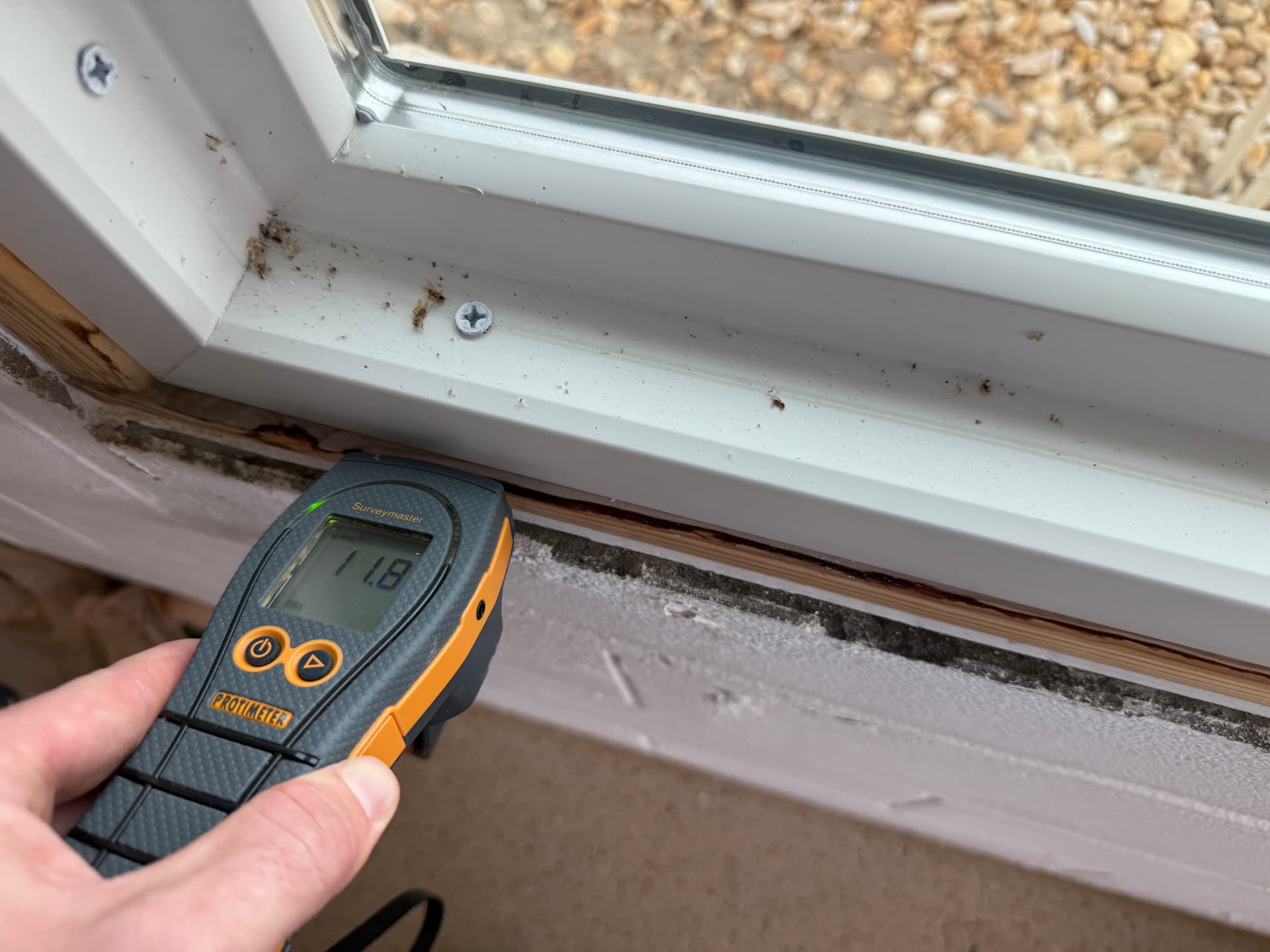

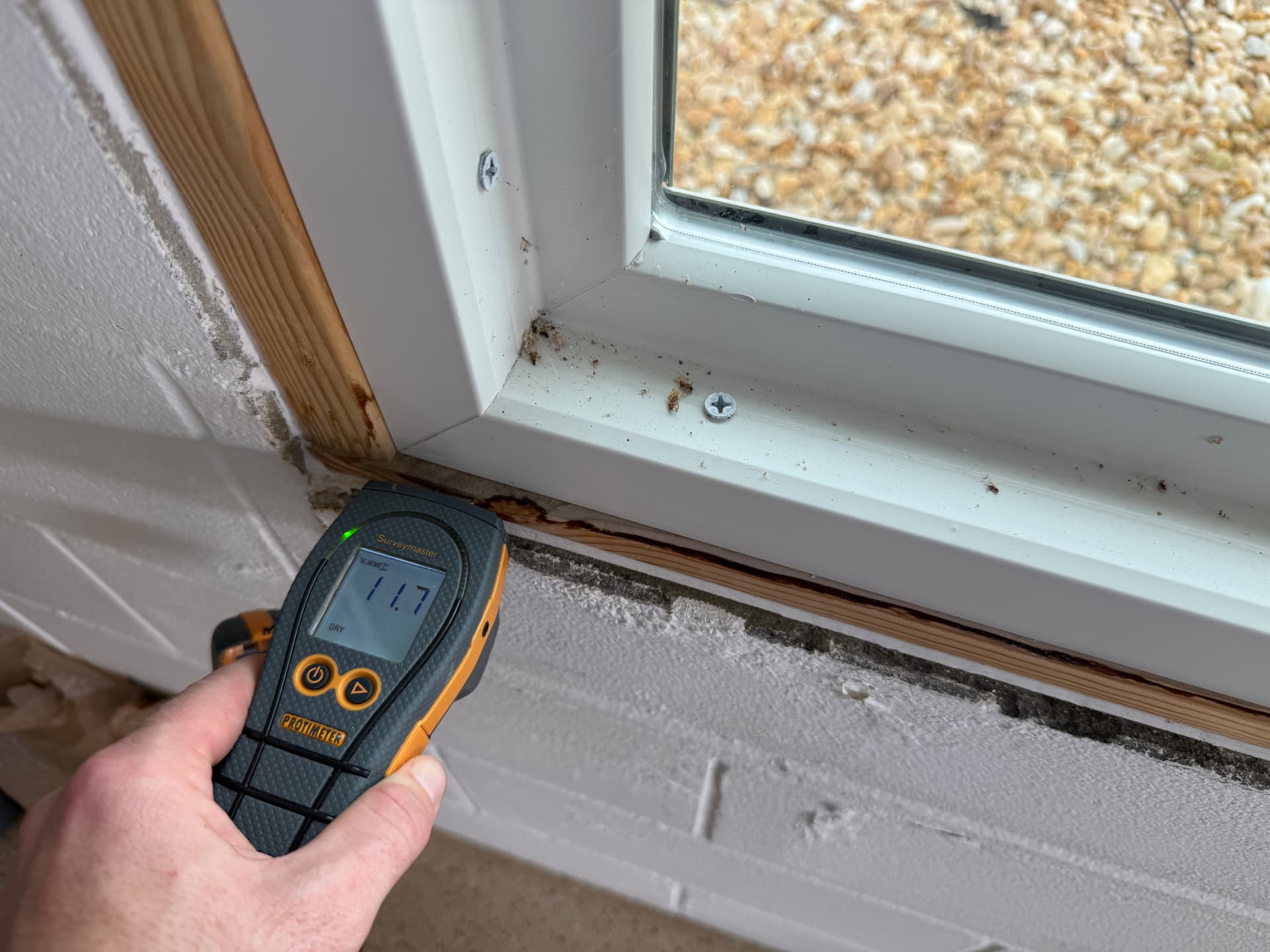

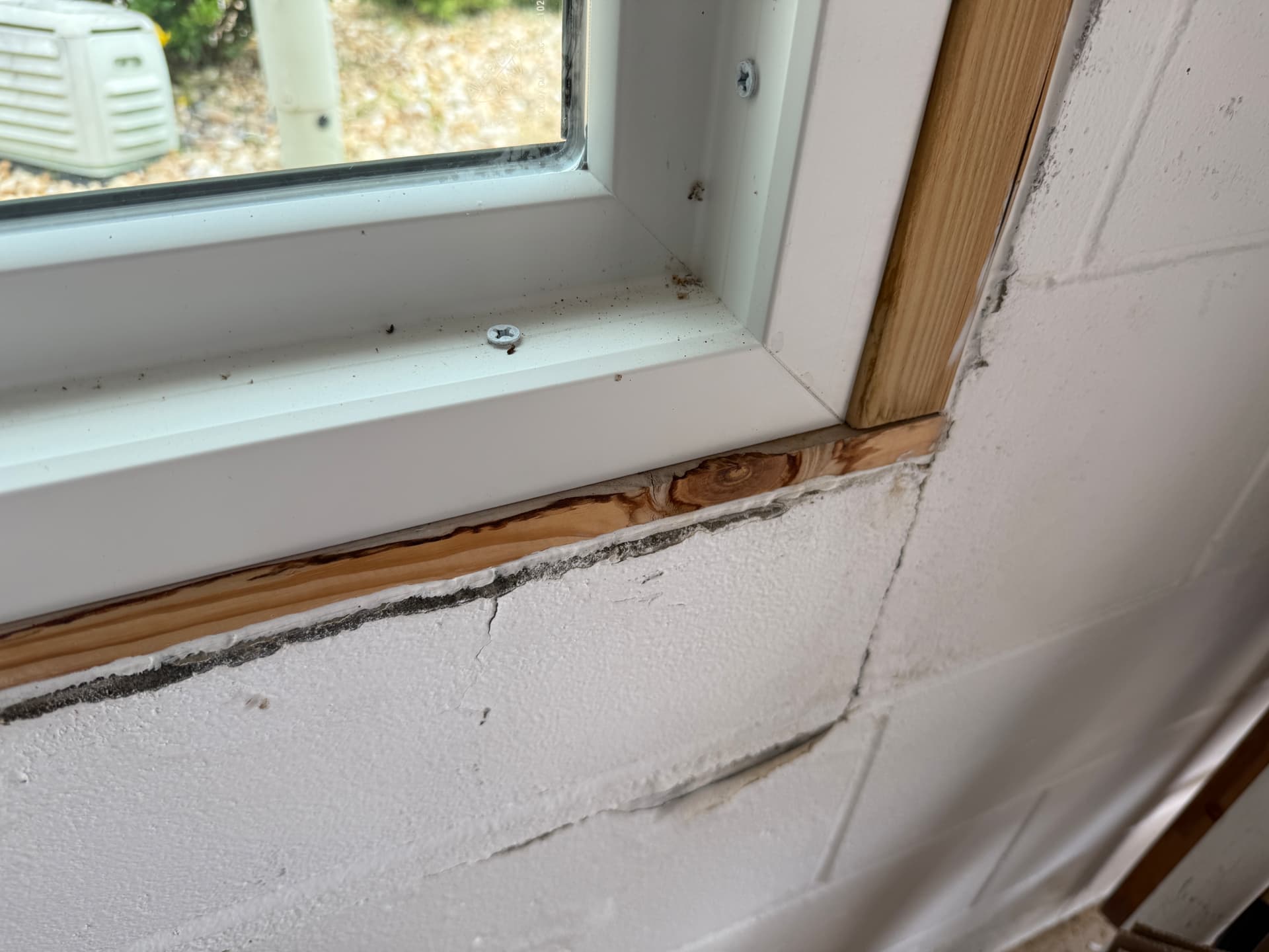

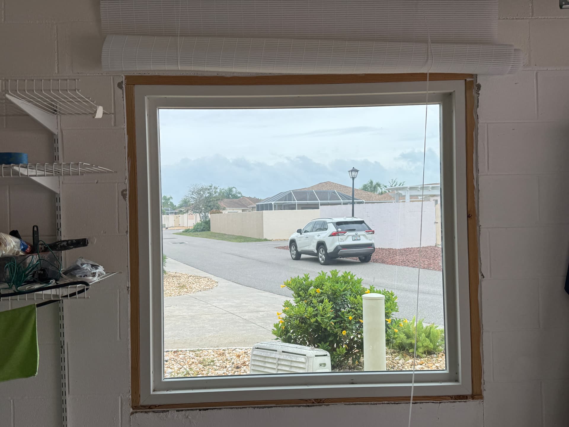

Did an inspection today where the house had new windows put in 2021. The garage window did not appear to have the pan flashing installed. The window framing had dry moisture stains.

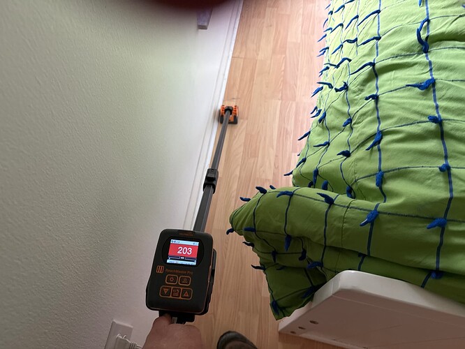

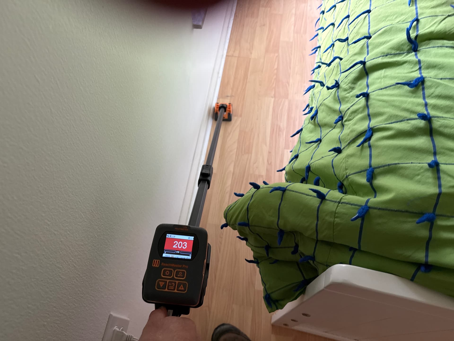

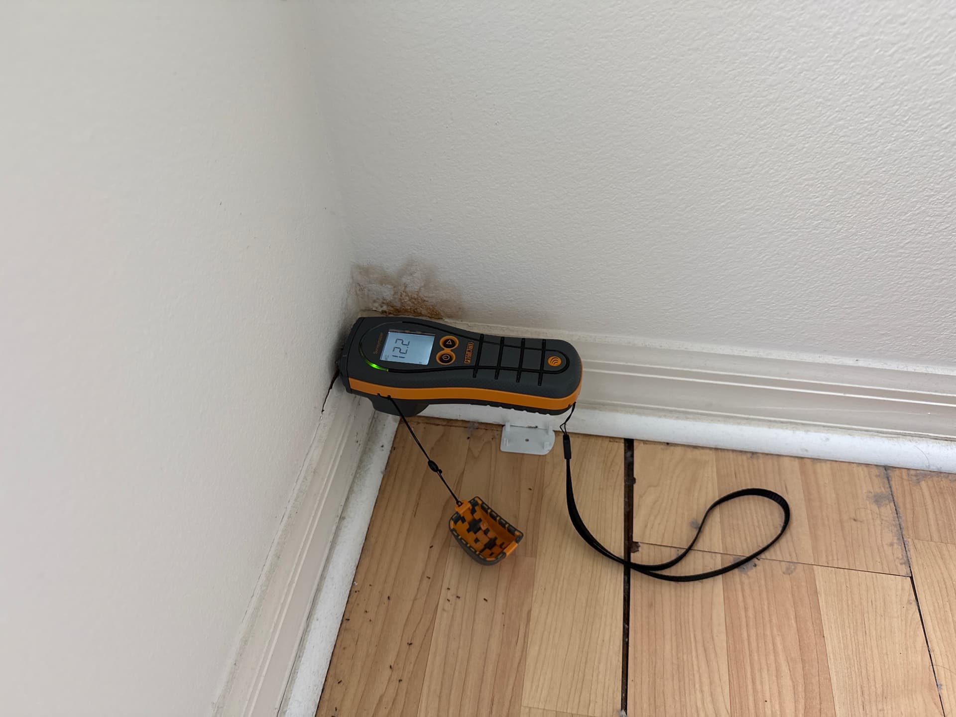

what I found in the guest bedroom has me thinking all the windows might have been installed without it. Dry stain on the drywall and warped flooring. but the floor away from the corner has elevated levels of moisture at the base of the window.

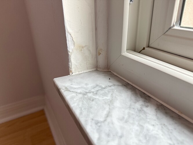

Master bedroom also has dry staining at the window sill.
Thoughts?
Did you take any readings on central interior walls away from windows to get a moisture level baseline?
(post deleted by author)
Yes all read dry
What moisture content reading was it that are you considering as dry?
Typically 90-160 is dry with the pole moisture meter
Hand held moisture meter 0-15 is dry
Hard to say if the water damage was done before or after the window was changed out. That said, I would call it out every time.
On a side note, as to the last photo of your original post. Be careful with readings when there is a corner bead present. It can give false readings.
fully aware! But, I always appreciate the reminder non the less :slight_smile:
Haven’t seen a pole moisture meter. Pretty cool.
Whether the stained areas are dry or moist, and whether or not I pull out my moisture meter; I am writing up my observation of those areas.

Replacement windows generally do not have a pan other than what is built into the window unit. The old windows are cutout and most of the time the pan that was in place is removed with the old window. New windows are put in place, secured with a few nails/screws and then sealed with sealant. One main reason that replacement windows often leak!

Suspect: Poorly installed replacement, or new Fix Window. Location: Bedroom.
Observation: Bowed/Sagging upper sash. Lack of visual shims. Shims are used too ensure the window is level, plumb, and square within the opening.
Suspect: Window frame Fasteners. Exposed screw heads on window frames can be unsightly, and may lead to rust or damage and can snag on fabric. Typically/usually, rightly/wrongly, I observe window frame fasteners through Shims to hold the shim in place.
Recommendation/s: Recommend a licensed professional window/door installation and replacement contractor, too further evaluate the fenestration, and replacement or new fixed window installation, and improve any noted defects or deficiencies therein.
As well as, to further protect my personal professional liabilities,… recommend following any licensed professional window/door installation replacement contractor recommendations therein.
Poorly installed fixed window.
Good post Scot! I concur. “Replacement windows generally do not have a pan” The bottom of the fenestration will be flashed with a pan when “the exterior envelope” requires a fenestration flashing pan.

I was having this discussion today with @rthoroman. It may not be an elevated moisture content, but it is not dry. Just something to consider when choosing a narrative.
