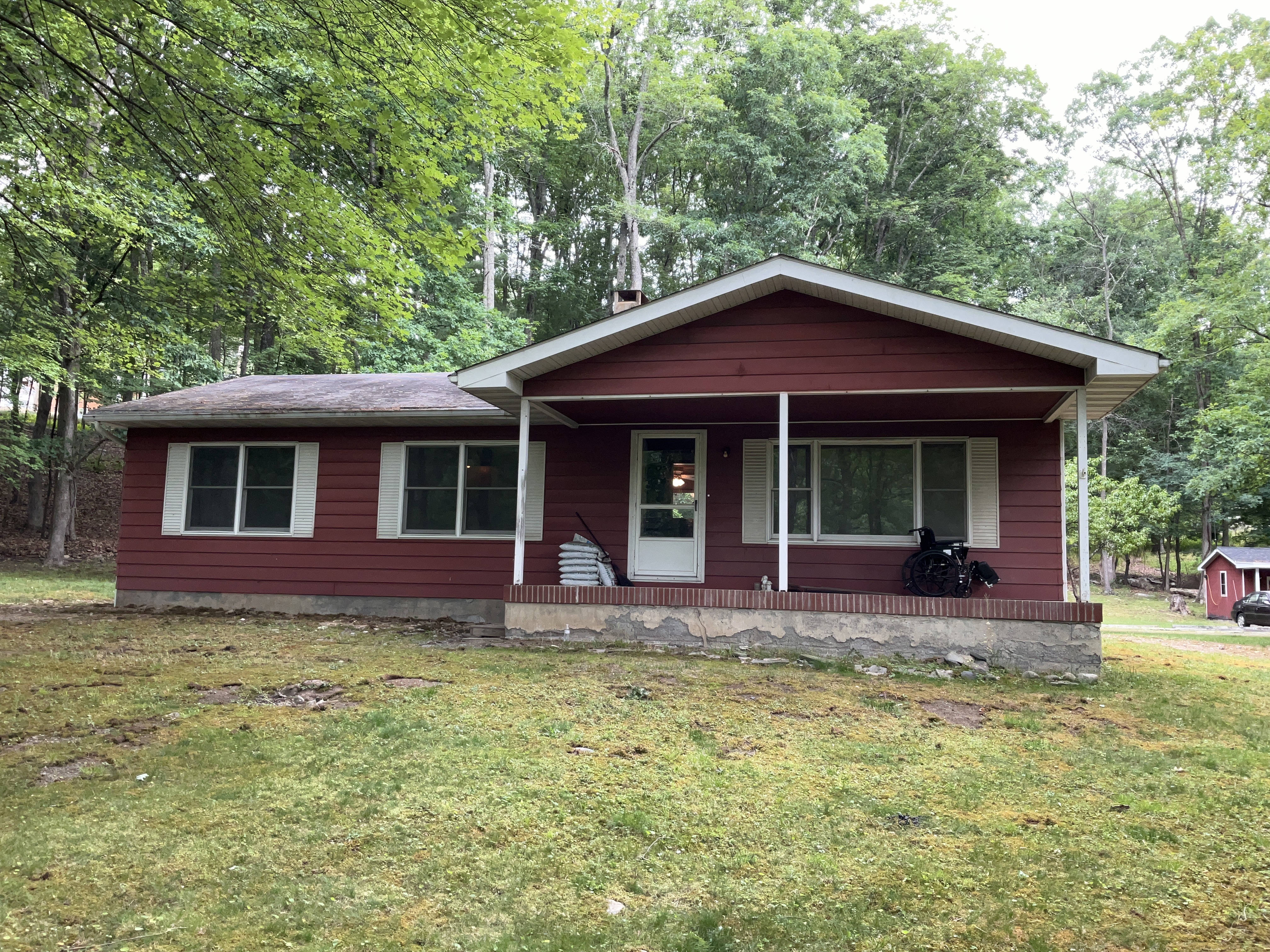

Wood Gussets 1976 Modular Ranch Home?
1976 modular home with steel joists connected with steel I Beam and brackets I also noticed steel rim joist construction!
Located in Pocono PA where we do get high winds not usually above 90 mph but hurricanes do come in this far but winds diminish sometimes!

Aside from the lack of insulation, inadequate or no vent, and the organic growth on the deck materials, I don’t see any problem with the structure and wouldn’t write up anything as a defect unless I see one.
But if you feel comfortable recommending a SE because you think the gussets aren’t properly attached, or whatever other reason you may want, then by all means do it and sleep well tonight.
But keep in mid that if you put a statement that the home isn’t built to current standards in your report, that you’d be putting that note/defect in every report for homes 5, 10, 20 years and older, as the “standards” are in a constant state of flux.
A home built to older standards doesn’t mean it’s not structurally sound.

Unless you see a defect in the roof system such as a broken rafter or significant sag I wouldn’t call out a modular home roof system as defective. Modular homes were engineered to the current building standards in the state in which they were built.

Just curious, what does outdated mean? Modern trusses use different materials. This does not mean the older materials are inferior. In fact, the wood truss material used back then appears to be much more superior than what is used today.
Furthermore, how do they repair damaged trusses/gussets today? Typically with plywood.

You have to calculate the node forces, the required repair throat areas, and fastener schemes. Just throwing up plywood and nails means nothing. I’ve lost count of the number of improperly repaired trusses that I’ve been called in to look at.

I would say the answer to your question is because metal gussets are cheaper and easier to manufacture and install than the old hand built trusses of the past with wooden gussets.

Unless the house is new, current standards are completely irrelevant. Your comments would provide no value to the customer and could cause undue concern and confusion on the part of someone who is trying to understand what the relevance of standards from a time other than when the house was built would have. If the house’s systems and components are in good condition and functioning as intended, that’s what matters.
Further, any reasonable person who buys an old home isn’t going to expect it to have modern materials or be built to standards that didn’t even exist when the home was built. No reasonable person is going to walk into a 50 year old house and expect it be built exactly the same as a house that was built today.
The question that you should ask yourself with ANYTHING that you put in a home inspection report is “What value does this information have to the reader of the report?” An inspection report should be clear, concise, accurate, and relevant. Standards from any time other than when the house was built are completely irrelevant.
