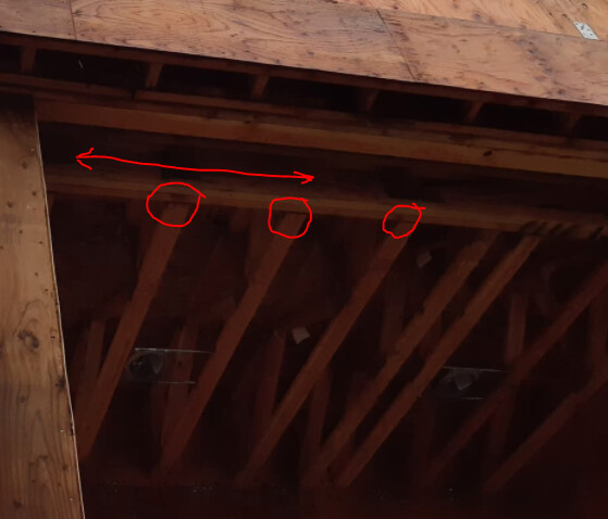

Did you grab a photo of the underside?
Call it “De Furred Maintenance”
I dont have photos but I checked the underside and didn’t see any posts. Looks like they framed the columns with 2x6s and plywood sheathing as if it was a wall. If there is a post it is in the middle of the colum but that wouldn’t work with the girder and a 4x12 beam running parallel to each other on the top.
Clasic WTF condition. I will let them figure it out and come back to see if it makes sense. They will probably need their engineer to help them with this.
This one is going to be fun. And what is going on under here? No hangers and a single i-joist carrying the load?
I am also curious how they are going to handle water across the top of this soffit?
This was exterior shearwall inspection, only.
The circled floor trusses were top chord bearing type that were supported by double truss girder. That was ok for now, I will take a closer look at them during the framing inspection.
You may want to look at the drawings and see what size post that is supposed to be and what size footing and how far the footing or wall was supposed to extend past the post.
Like Brian mentioned something just don’t look right with this framing.
