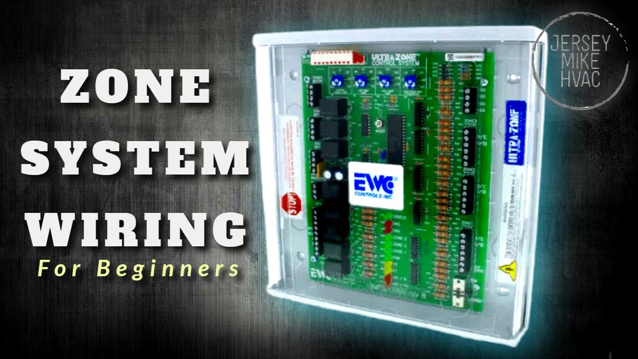

Jeff, That’s helpful and I’ll try to convey that to my client. Are you OK if I share that verbatim? David’s post got me thinking and I just watched this video on youtube, which was very educational for me.
