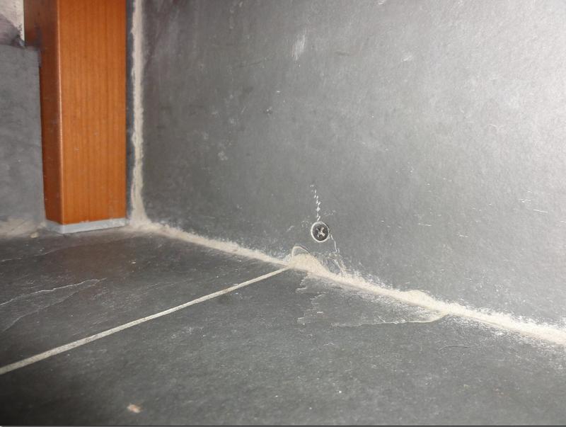

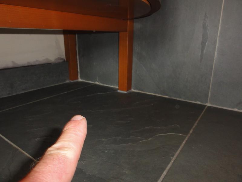

Here is the very last spa tub I did.
Talk about lack of access.
I observe and notate with words plus pictures to CYA.
Yes ,I make a good case for taking lots of pictures.
[ATTACH][ATTACH]
[/ATTACH][/ATTACH]
I guess I could have not been so lazy and just moved the sink to inspect the pump area.:roll:

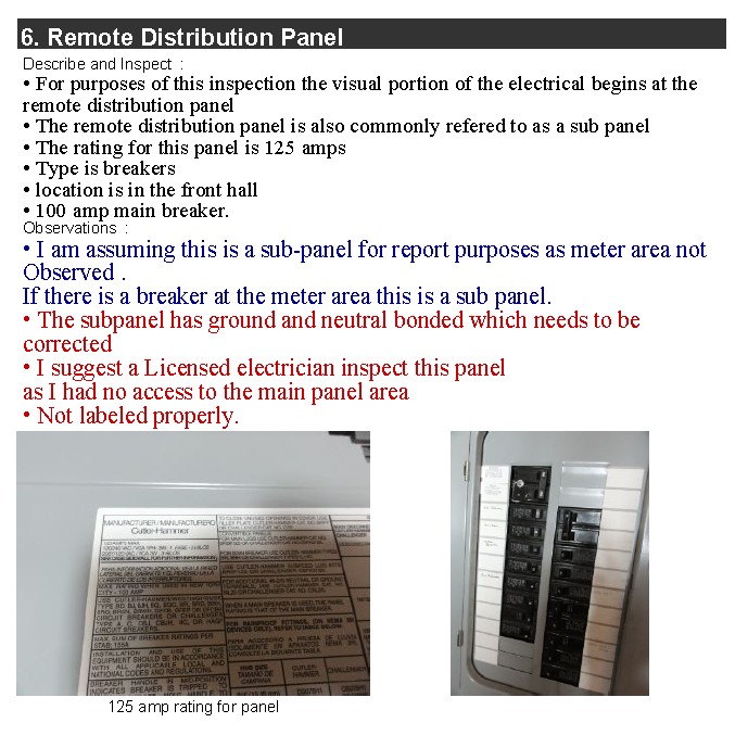

On quick follow up to this question, the CYA part of it happens when you examine the electrical panel.
Here is a direct shot off the same report.
Please observe some of my language is just not going to happen in a click (PDA) or checklist style report.
Narrative at the office is way to go IMO.
I like this as a good example of the three color text option also ,by the way.
(only red goes to summary)
The info is a little confusing Bob. The panel rating is 125 amp, the “main” breaker is 100 amp?, and you’re assuming it’s a sub-panel and the “breaker” is at the meter (this would put the “main” disconnect at the meter).
Actually you just confused me Chris :slight_smile:
The panel rating is 125 amps (you check the panel label for that)
The main breaker for the sub is rated at 100 amps
Chris please go back over it,(read the blue comments) as I state I’m assuming it is because this is a high rise Condo.(I know you do not get them often)however my client had it explained in detail on site.
That is where experience comes in.
Hard to get much more detailed with so few words but I state the exact facts that so many seem to just leave out when they do all checklist and canned reports.:slight_smile:
That is why my clients have never called confused about my reports (ever) and I am proud of that record.
I report for my client, and not the mis-placed forum scrutiny.:slight_smile:
“Wish you well”

Alright guys here is how this issue ended. I was tired of getting different stories and I wanted to know what my $150 actually paid for. So I requested an invoice from the sellers agent. I recieved three invoices 1) Plumber for $138.25, 2) Electrician for $85.50 3) Handyman for $70.00 for repair of tub casing and trim after removal of enclosure.
The electrician wrote on the invoice. “Whirlpool not coming on ended up pulling small cabinet (which was sealed) to gain access to the pump and electrical, found no power to unit found GDCI had tripped no problems found with operation of whirlpool tub after reset and testing”

#1 - Was the GFCI the electrician referred to - - UNDER the SEALED tub compartment? If so, politely tell them to stuff it
#2 - If there was no problem AFTER the GFCI was reset / WHY were the plumber and handyman out there?
#3 - Can you NOT recognize a Blow Job when you see one?
#4 - Cut these Bozo’s loose / You don’t need to be doing business with bottom feeders like this.
Yeah it was sealed in they had the handyman out to reattch the tub compartment and re caulk it.
So Eric are you saying the GCFI is installed in the sealed compartment, inaccessible, and after the fiasco it is still installed that way?
Yeah they resealed it up makes alot of sense huh?
My next question to them would have been, “What do you intend to do if and when it trips again?” GFCIs don’t just trip for no reason and when it does, not for the reason most people think. Design flaw at the time of installation and certainly not your fault. If you pointed out a problem, it doesn’t automatically become “your problem”. What you can expect now, is that every time something fails or does not work properly they will look to you to pay for the corrections. As said, a dangerous precedence has been set.

I would never remove the marble tub skirt even if it wasn’t caulked. The skirts are only 1/4 to 3/8 inches thick and are very fragile. One slip and it is broken. There goes $150 to $200. You may not be able to get one to match the tub, then you may have to replace the tub ($1000 or more).
A metal or plastic panel, yes. A marble skirt and it is not accessible.
