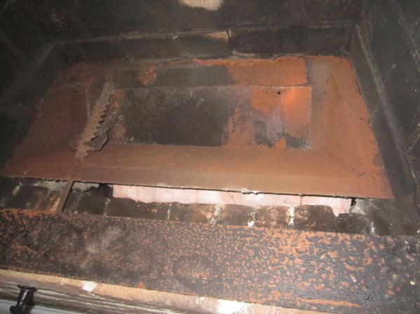

I inspected a house that had a chimney that was used for the fireplace and furnace, which had a chimney liner for the furnace. I observed a gap between the damper and the masonry that needs to be sealed, which I definitely will report but otherwise the masonry and ceramic liner of the fireplace chimney did not look bad at all.

I thought the mortar on the fireplace chimney was in exceptional condition for its age. Not much deterioration for 90 years. Likewise, the ceramic liner of the fireplace/furnace chimney. The gap between the damper and masonry should definitely be sealed, though, as much to minimize heat loss in the Michigan winters as anything else.
