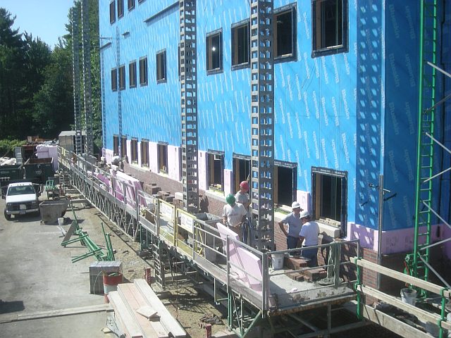

The only solution is to insulate on the outside of the steel studs, which is easy, elegant, effective and efficient. Leave the cavity empty—put the insulation on the outside (Photograph 5). Done. Except when we actually do this, we don’t get the credit for it we deserve. We actually get penalized code wise and cost wise. Put an R-19 batt in a steel stud wall and you are lucky to get R-5 to R-6 in the real world. That’s equal thermal resistance wise to about 1 inch of rigid insulation installed on the outside of the steel studs. With an R-19 batt you meet the “nominal” code requirement. Know what “nominal” means? It means “in name only.” It is not the true performance. In a perversion of thermodynamics, most codes require you to install 4 inches of rigid insulation on the outside of the steel studs—a “real” R-20 – to meet “equivalence” to the code stipulated “nominal” R-19.
http://www.buildingscience.com/documents/insights/resolveUid/907b361e1b878f01a25649fb91381142
Photo 5: Exterior Insulation—The pink is the exterior insulation. The blue is the rain control layer (drainage plane) and the air control layer (air barrier) and the vapor control layer. The brown is the brick cladding.
If life was fair, 1 inch of rigid insulation on the outside of a steel stud wall assembly would be equal to installing R-19 in the cavity. It is equal in the real world, but not in the code world.3

Okay, the field of the wall is easy—exterior insulation. Now it gets ugly. How do you handle the frame? How about running the insulation past the frame as with the exterior insulation on the steel studs in the infill wall? Not so fast. How are you going to support the cladding with this exterior insulation between it and the structure? That masonry veneer that architects love and client’s want is typically supported on a relieving angle welded to plates cast into the concrete slab edge (Figure 2). Or even more thermally conductive, the relieving angle is attached directly to a steel frame.
http://www.buildingscience.com/documents/insights/resolveUid/e26eee04e24057ab17c083456bc0d9af
Figure 2:“Clint Eastwood” Thermodynamics—“The Good” uses offsets and exterior insulation. “The Bad” only uses exterior insulation. “The Ugly” uses neither.
Running the exterior insulation over the upturned angle doesn’t get you much because the two dimensional heat transfer gets you bad (see heat rejection efficiency of steel studs earlier). You spend a lot more money on the steel angle. It now has to be wide enough to accommodate the thickness of the exterior insulation and thick enough to handle the moment loading.4 The thicker angle transfers the heat even faster, so you actually loose more than you gain. So if we spend lots of money and get little in return, at least we are consistent.
We can fix this by standing the steel angle off the face of the frame with “off-sets.” Steel “C-sections,” tubes or knife-edges are attached intermittently to the structural frame to hold the steel angle away from the frame, allowing exterior insulation to run past the steel angle between it and the frame (Photograph 6). Now, you can use a small and standard-sized steel angle because the stand-offs do all of the work. They handle that “moment” thing that worries structural engineers. This approach has the added advantage of better accommodating dimensional variations in the slab edge and allows for better rainwater control (“drainage plane”) details.
http://www.buildingscience.com/documents/insights/resolveUid/7d59268b38deb3ca655019abced6a9ae
Photo 6a: Offset Relieving Angle—The angle iron support for the brick veneer is held away from the structural frame allowing exterior insulation to run by.
http://www.buildingscience.com/documents/insights/resolveUid/b995c0086132e5f4fe000ee0f92c450f
Photo 6b: Offset Relieving Angle—The angle iron support for the brick veneer is held away from the structural frame allowing exterior insulation to run by.
