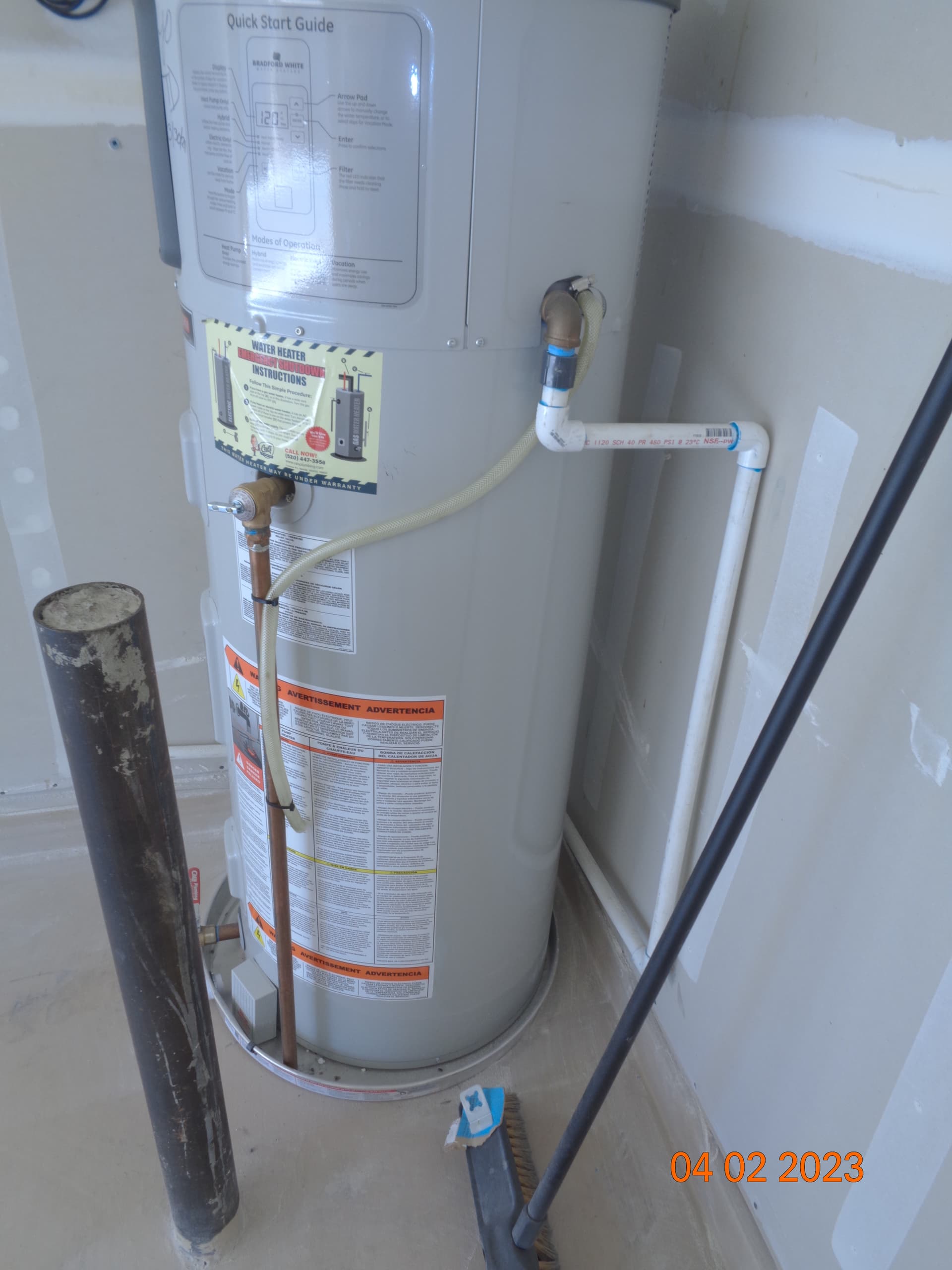

A heat pump water heater… Googled it but could not see why lines are coming off the side of the tank…
This might help…
High Efficiency Heat Pump Water Heaters
Condensation drain for the heat pump.
I agree with Roy that it is a condensation line.

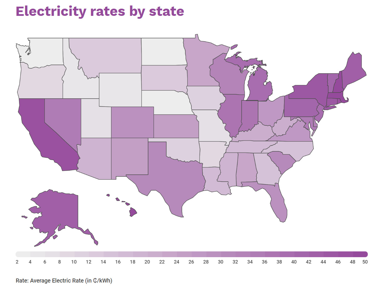

Here in TN and GA our climate is mild and electricity is cheap (less than 12 cent per kWh) so lots of homes are heated and cooled with heat pumps.
Up in New England like VT and MA the rate is over 30 cents/kWh and winter temps often dip under 20F so basic residential heat pumps are not the best choice.
for the same reasons, Heat pump WH (aka Hybrid WH) will make more sense in warmer climates.
Are you referring to the PVC or the hose? I’ve never seen one of these in the wild.
Both, to me it looks like the PVC line is the “main” condensation line with the rubber hose being a sort of a “secondary” overflow in case the main line cloggs.
I’m not real familiar with these systems but that’s what been able to conclude from what I’ve found online.

Not the drain diagram on the unit.
Does not look like it is hooked up to the heat pump.
The pics attached above are not the same water heater you’re asking about.
