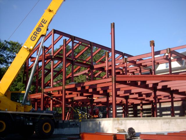

Thursday morning, time to erect.
Starting to take shape.
Christmass tree, is picking up three beams at a time to same installation time.
Main floor and columns were all erected in one day with one steel worker.
Three support people on the ground.
Not including myself.
I was looking out the door of my office to make sure everything was being orchestrated right. ha. ha.
Marcel :slight_smile: :slight_smile:

Book store update on the steel erection.
Steel beams a flying.
Last piece at 3:00pm
Done
Pack up the Crane.
