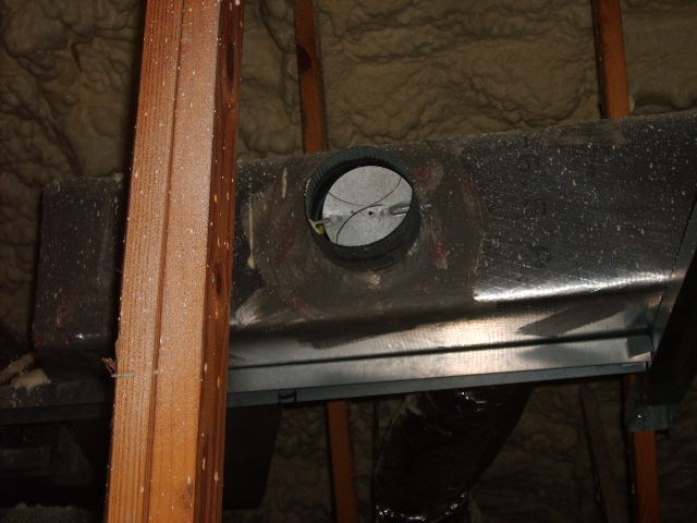

I am new to HI industry. Just completed an inspection in Pensecola Florida. There were two 2 ton (all electric) units in a new three story -duplex.
In the attic, the plenum had a A/C duct with a louver. The louver wasn’t sealed all the way, and cold air was discharging into the attic. It seemed to me,that this should have been sealed (capped) off. Can anyone explain if this is common? Thanks.:roll:

Here are two photos of the opened duct. The attic had foam insulation throughout it extending to the soffit. No space for soffit air circulation. Is this considered okay? I thought insulation should never be over soffit vent area.
That is a balancing damper and the duct to it is missing!
Any air leak (regardless of size)results in the same volume of unconditioned air being drawn into the conditioned house.
First you loose the conditioned air, then you replace it with unconditioned air that loads the system (beyond capacity in many cases).

Looks and sounds like they did indeed create (or try to create) a conditioned attic. This duct take off should be sealed but being unsealed is not as big a problem as some may think.

To start with, you don’t put a supply into a closed space without a return or it will pressurize the space forcing air through the walls/roof to the exterior which is an efficiency concern.
If you blow conditioned air into the attic where does the displaced air go?

This is a conditioned attic, sealed off from the exterior by spray foam. The amount of air leaking around this small closed damper may be what…8-10-15 CFM in a system of 1000-2000 CFM…not a big deal and it is into a conditioned space. Jeez, a 4" duct is only rated to carry 40 CFM in good designs.

No, don’t think it’s a conditioned attic. I think someone left the seal off this return. I haven’t seen this before with louver not capped.

This is not a duct, it is a take off. 40 cfm in 100 ft of 4" duct only has a static friction pressure of .11. This take off has practicly no resistance. You can get 90 cfm at just .50 inch h20/100 ft.
You are probably correct about the amount of CFM passing through it though, because if they do not have both a supply and return source, and the attic space is fully sealed and pressurized, air flow will be diminished. Not because it’s a closed damper though.

[size=2]Also, a closed balancing damper is not an “insignificant” air leak!
