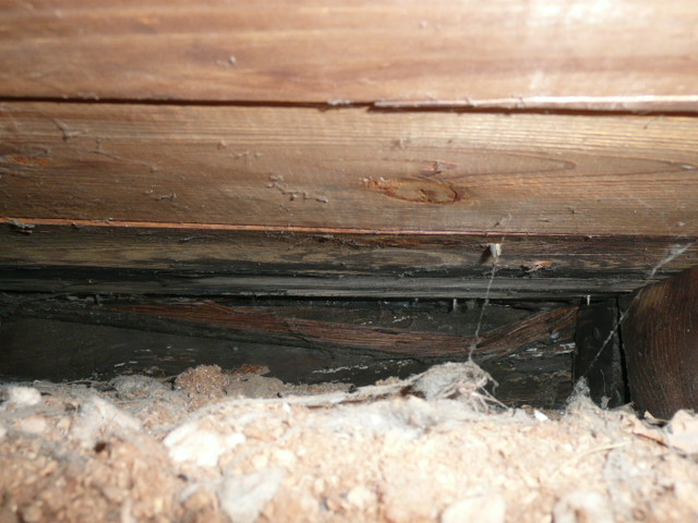

My McDonald’s Big Breakfast that is, after seeing this yesterday morning…
Yeah…:-k…I don’t see it. What was it?
Poor attic ventilation?
What a coincidence…My morning inspection yesterday was worse.
All roof sheathing was loaded with gray hairy mold looking substance and the moisture content was ridiculously high.
I could see that the Sellers closed off all their soffit vents because it was too cold in the attic.
I’m amazed to see how many homeowners are building science illiterate. I think every homeowner should be required to take a first time buyers program in order to save their homes. I teach all my clients about their attic ventilation while inspecting the attic.
I also had one yesterday and one on Friday that were lacking outside air flow into the attic through the soffits. (no baffles) One was a home inspectors home.

80 year old with no soffit vents! However, there was a great deal of air circulation created by all the holes in the frame, fascia and eaves.

Sounds like this guy has a pretty unique method of “going green” with the fungii of his choice.![]()
This place might have been my first crack house. Furnace had no filter, empty clorox bottle supporting the TPR valve and look how they’ve been using their clothes dryer…:shock:
That’s one reason why I always have my respirator on when I first enter an attic or crawl space. I hope you never have to go in an attic that has or had bats living in it. I ran like hell.
