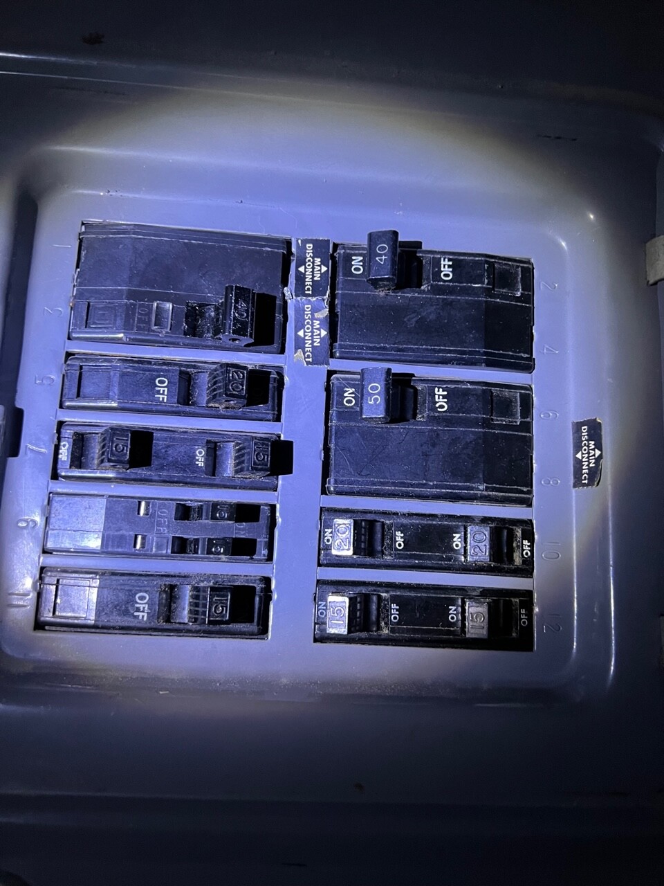

I ran across an older square D box that had three breakers at the top all marked ‘Main Disconnect’. Two were 40 amp breakers and one was a 50 amp breaker. Do I call this a 130 amp service?
If yes, I assume we do the same with Pushmatic service panels?

What size were the service entrance conductors? Do you have a photo without the cover?
I don’t know the service entrance conductor size. It was more of a general question. Let’s assume the conductors are adequately sized.

Probably a split bus panel.
You can’t assume. Depending on the actual setup inside the panel, the service entrance conductor size is one of a few items that will determine the 'Service size" of the system, ‘not’ adding up the breakers.

Photos would help to get you a correct answer because there are too many variables that aren’t addressed in the photo that you’ve posted. Could be as simple as someone mistakenly installed the stickers.

Really more info is needed…like with the dead front off as Rob asked about.
If unsure, refer it out to a qualified Electrician. But do not assume, as JJ said.

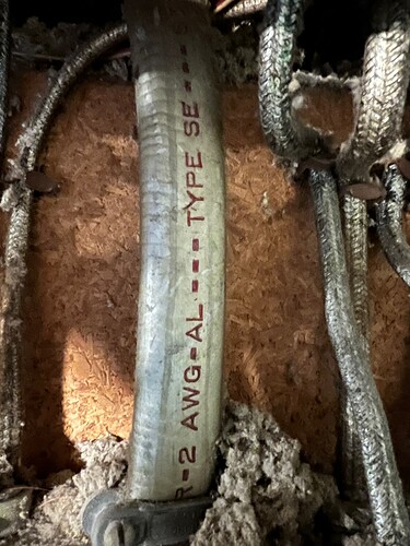

Additional photos below. I’ve always just used the main breaker amp rating as the reported service amp. A majority of the time, I am not able to read markings on the service entrance wires.
The original question was ‘How do I determine service amps when there are multiple mains’. Maybe a better question is ‘what are best practices for determining service amps’.

Not only no, but HELL NO!!
You need to learn the proper way to determine the service size.
#2 SEU Aluminum service entrance cable = 100A rating, the NEC 310 tables are your friend:

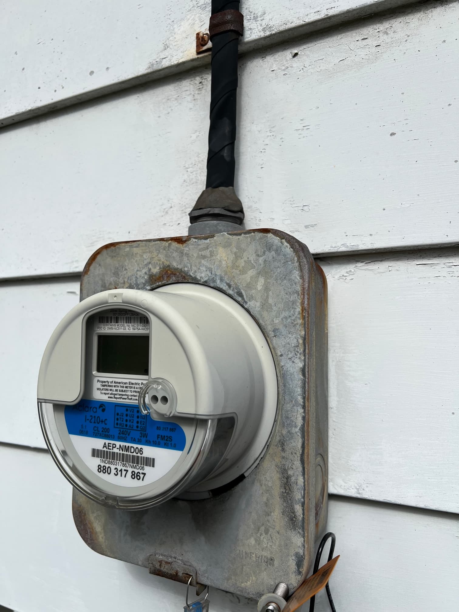

That old meter socket may only be rated for 100A, and that panel box is 125A…

Interesting… I didn’t notice that.
