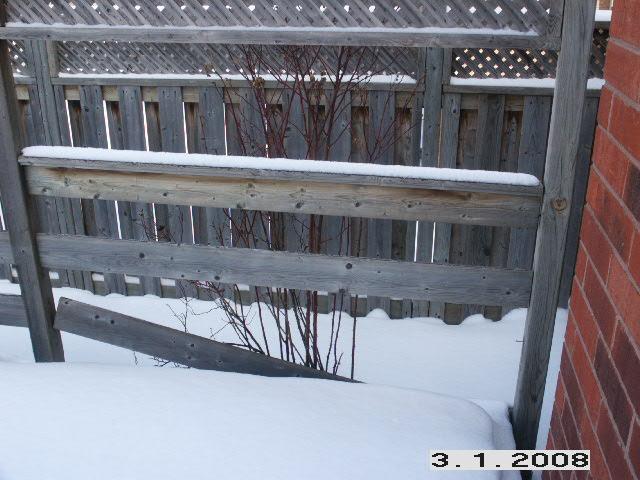

Speaking of decks, here are couple pictures from today’s inspection.
