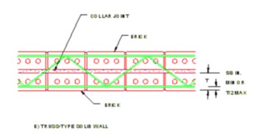

I think I know what you are trying to describe, which is a running bond double wythe brick wall that has horizontally staggered facing wythes and backing wythes (like in the attached pic), where the bricks interlock with each other at wall intersections … that a tough one … :slight_smile:
For lightly loaded brick walls I typically just see ladder/truss type horizontal joint reinforcement (about every 6th brick course or 16" o.c. max) for double wythe brick walls in running bond used to tie the facing wythe to the backing wythe, which also strengthens the wall and the intersections.
The interlocking wall intersections and joint reinforcement also become more critical either when there is no platform framing attached to the top of the walls, or for higher exposed walls subject to more severe earth, wind, or seismic loads (e.g. per IRC R606.9.1 & 608.1)

In the photo for the veneer.
#1: The brick should be 6" above grade.
#2: the brick bond is wrong for a double wythe brick bond layout.
Double wythe clay brick veneer ( lock ) bonding is paralleled in all directions.
#3: I see no weep holes.

2.) Brick Bond – the brick pattern created by the positioning of headers
( width butt ) and stretches. ( face or lenght )
It is mathematical equation that strengthens the field. ( brick, CMU,S, to wall boards )
Notice how the brick headers ( butt ends ) are staged on the top of the parallel plain wythe in the illustration Joe.
Look at your photo. Headers ( butt joints ) are inline and not staggered. The walls field loses the purpose for the double wythe wall strength.
Headers should appose each other butt face on the common or stretchers bond run when the wythe is double…
The plains intersection ( corners ) is also wrong.
Because of the running band to start with. The mathematical equation is lost. The lateral and horizontal stability diminished.
