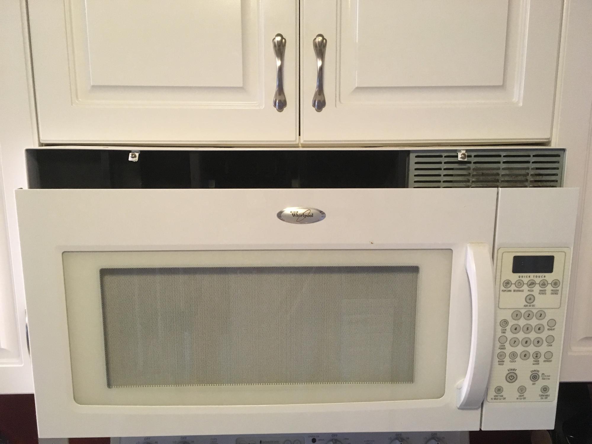

I typically use my own home for examples in these essays. Not long ago, the microwave vent cover broke off at the screws. You can see in the picture that the vent is there but the hood is missing. Although the cover is missing, it is still functional. If I found this in an inspection, I’d recommend to the client to have it repaired or replaced.
