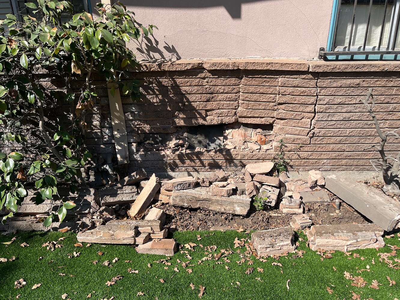

Today was my first paid inspection, and this was what I encountered. So from what I read on the forum this isn’t a retaining wall is a brick veneer with and how would I write this damage to this wall up in my report is where I’m stuck at.
Well the key word would be damaged
Example:
Substantial damage to brick veneer at LOCATION. Recommend qualified brick mason, and other qualified professionals, make repairs as needed to restore structural integrity of complete wall system.
And welcome Mitch! :+1:
Thank you, so much appreciate the feed back
