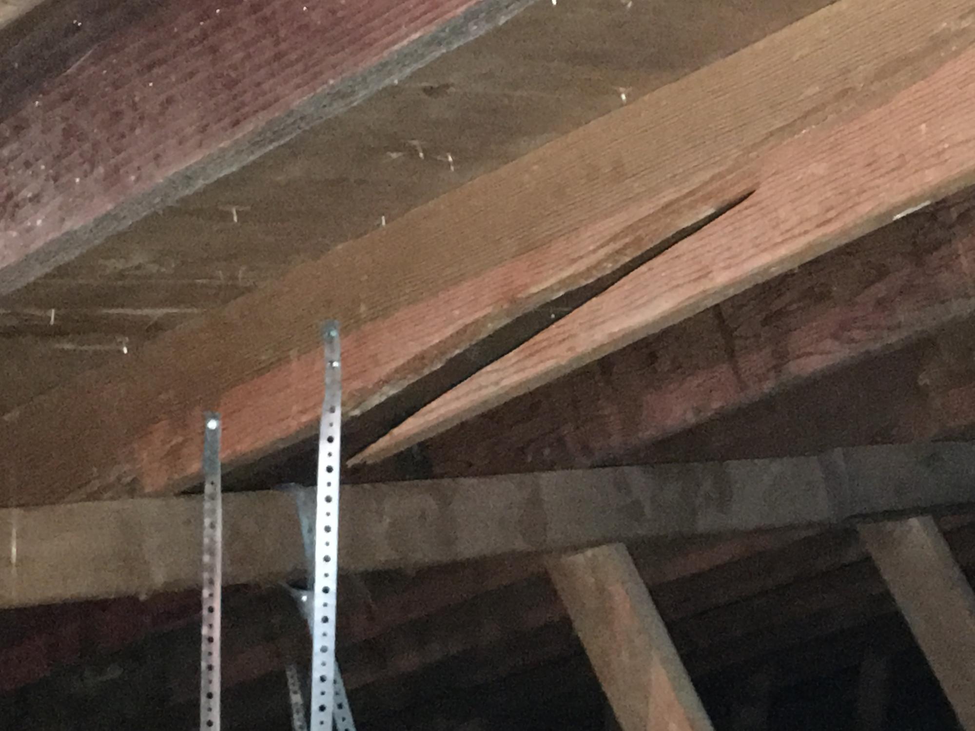

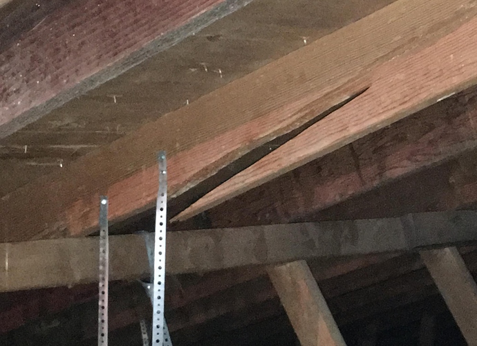

Have a look at one of several cracked rafters I found on an inspection yesterday. What would have caused this much damage to over a dozens rafters. Some were split worse than others and several rafters were pulled away from the ridge board. Any thoughts out there ??

Unless it was impact damage, the most common cause is inferior grade lumber that already had a crack / split when installed, and just opened up when dried out in a hot attic.
Thanks, my original thought was a tree may have fallen several years ago as the split rafters seemed to be in a specific area of the roof. Appreciate your feedback !
