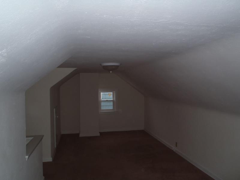

When I was on the balcony I was looking more closely at the post and did not see any signs of settlement, could not tell if it was load bearing as Marcel indicated. I think a proper support at the corner to the ground woul;d be an appropriate repair but I will leave that to the SE that I recommended. Nice older home by the way. Except for the red regergitated droppings in the attic that I kneeled in, Glad I had my knee pads on.

Did you go to the attic?

No access to that area.
To much animal crap, knob & tube, loose boards, finishing materials to get over there. Gable was finished.
Why do they finish the 3rd floor when the insulation, ventilation, wiring is all old and not energy efficient?
Gable was completely blocked with insulation, (What is a baffle) roof had little or now venting except for the large openings allowing in the wildlife.

Is that 3rd floor area used as a bedroom or “rec”/other use room. If used as a bedroom, would the window(s…if another is installed) meet the codes for emergency egress? The one one in the picture seems a bit small (by our Cdn standards). Don’t know what IRC or your local says.
I would say a interior room and not a bed as there is no closet, unless you consider an attic knee wall a closet.
Closet does not make it a bedroom.
Egress and privacy do.Example is they would need a door at the bottom of those steps.
You can always jump out to the sagging balcony.
