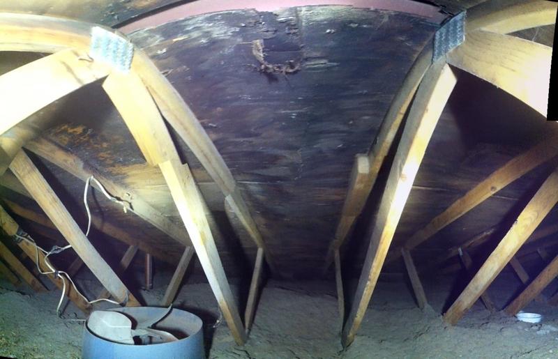

Interior air entering the attic in cold climates? Here’s what happens.
I got to see this just yesterday. The owner had removed the whole house fan louvered cover “four years ago”(his words). He had no idea.
Oh and the one photo is a stitched panorama, thus the few warped sections of the photo.
And don’t let a contractor try to argue that stuffing the end of the bathroom exhaust pipe down into the eaves is good enough. Like Stephen said, anyone that says that is ok is also an idiot.

I take it most of you don’t approve. I see this at 75% of houses I inspect, homes listing price does not seem to matter.
First photo from today, and this attic had turbine roof vents (the worst).
Second from 2 months ago. This was the home of the builder of the development this house is located. He told me it was a stupid requirement to vent at exterior. Three baths vented at main attic, I couldn’t locate huge master bath vent, it wasn’t at the exterior.
Again the turbines being the worst.

There are certainly many homes with bath vents entering an attic with excellent ventilation which have been that way for forty years and there is not a spot of bio-growth present.
That builder’s experience may simply be too shallow to have seen the effects of it. There are many different circumstances which affect the outcome of a bath vent entering the attic space: number, age & gender of the occupants, which bathrooms are used most, orientation of the home/roof, tree cover, prevailing wind direction, average snowfall, construction of the roof & roofing system, level of insulation, average indoor temp, etc. etc. I could go on and on. They all can play a part not only in whether moisture is entering the attic but also what that moisture does when it gets there.
For an inspector working in cold climates the issue is not the statistical chance of it causing a problem, it’s the fact that the potential is there and we are unable to predict the future changes to the above list of circumstances which have an affect on it. That contractor is right, in some homes with certain people and specific circumstances there is no need to vent bathrooms to the exterior. And his point is totally irrelevant to home inspectors. ![]()
