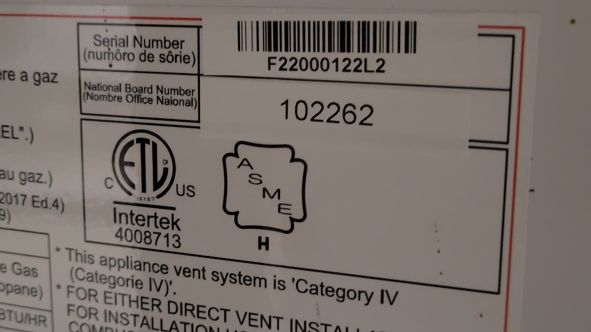

At today’s inspection I had a Bradford White boiler. The Building Intelligence site does not list boilers for this company, only water heaters. Does anyone have a resource for aging these boilers?
Thanks.
Can u share the data plate photo or model/serial information, please?
Not older than…
…and wasn’t available on the market in the US & CA until May of 2021.
Do you have a photo of the entire data plate?
No pic of the entire plate. I called Bradford White. The warranty service department told me that the number after the letter F is the year of manufacture. She had to look up the rest of the date in their system. Build date was 11/11/2022.
