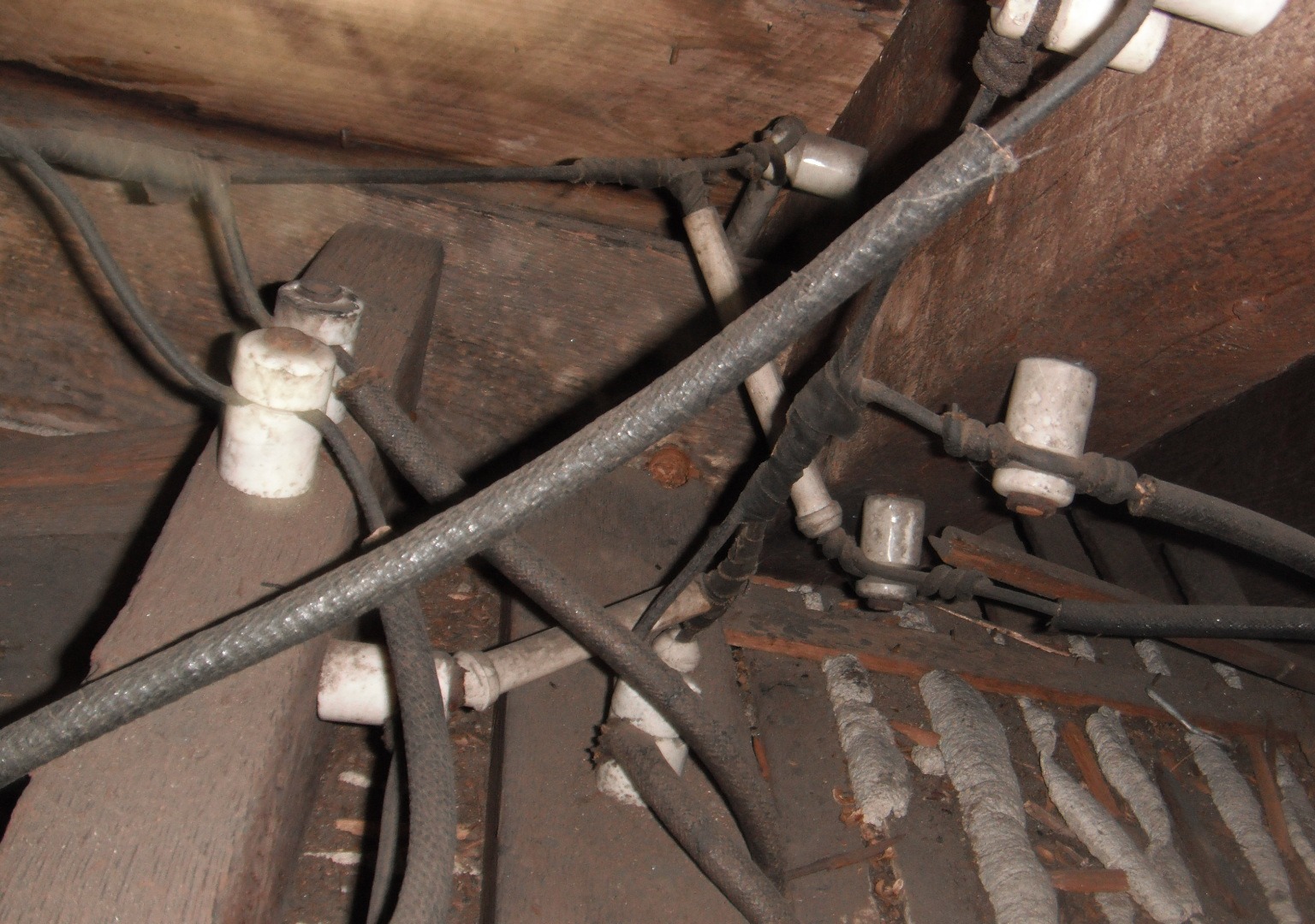

Branch circuits can have many connection points where they go in different directions. They can be at the breaker or at any point downstream. They are most often located in junction boxes, but they can be at a breaker too. Multiple conductors do not constitute multiple circuits. The source, which is most often, but not necessarily, is usually a breaker.
To help visualize this, consider a typical Knob & Tube system!
