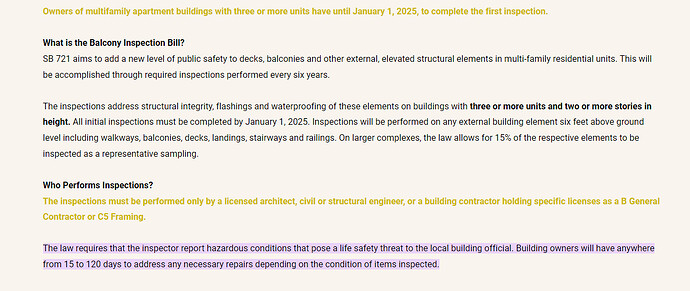

I have a question about the new SB 721 Deck Inspection law in CA. Does the Certified Deck inspection course through InterNACHI qualify for these additional inspections? If not will InterNACHI be working on a course that can qualify me? I’m an inspector in nor cal and starting to get a lot of inquiries about this as it comes on line in 2025.
Thanks Community!
Dan
Does not apply to “Standard” Home Inspectors
