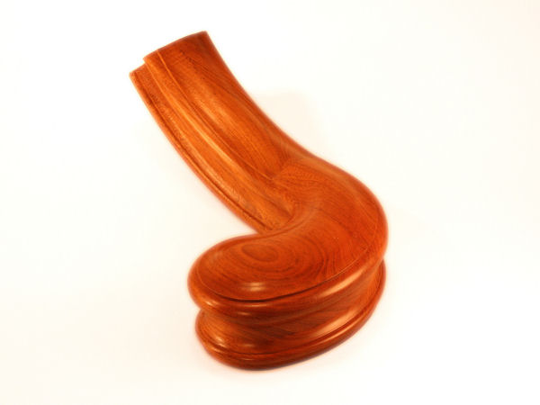

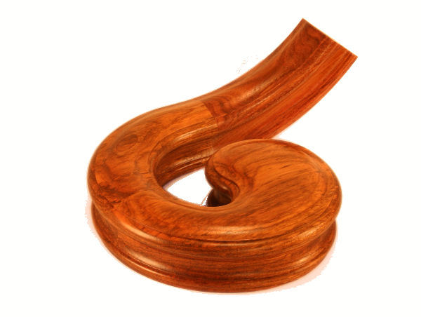

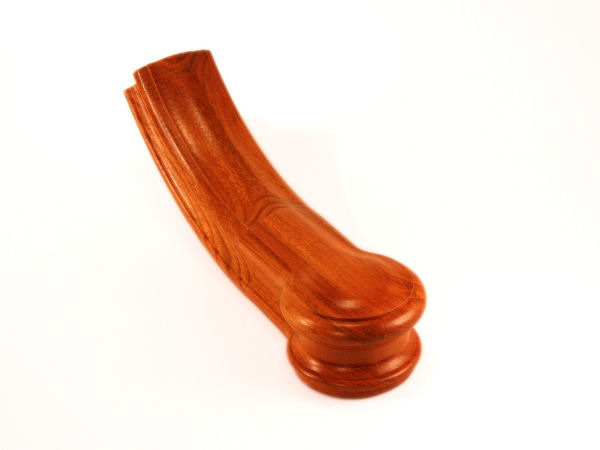

A handrail is no longer considered “continuous” when 1,2, or 3 is installed at the bottom tread. True or False?

Bigger question is whether or not the client would even care.
Maybe it was the way the question was worded. These may all be utilized, providing they are supported vertically (downward/upward pressure) from the bottom tread. It is ususally the starting or ending point of the handrail, so what does “continuous” have to do with anything?
A more practical question having to do with handrails is in an older colonial, where there is a jog in the wall. My home is 9 years old, and I have such a jog ibn my wall. The handrail id not, continuous. The stair installer performed the installation, and it was inspected and acceptable to the AHJ.
Technically, the handrail should have curved around the jog to be continuous, but it doesnt. Why was this allowed by the AJH, who busted balls on almost everything else? Very experienced AJH. Nice guy, but was a stickler.
