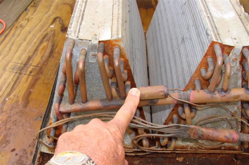

Can you see it

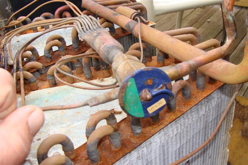

This is a 4 ton A-coil set up non adjustable expansion valve with external equalizer line IMO there is a engineering flaw in the design set up can you see it and would you have the intestinal fortitude to call it if you would have seen this.
BTW did you know the color of the sticker on the expansion valve denotes the type of freon the valve is designed for green=R-22
The odds of it ever happening are almost non-existing but if the expansion valve was visible and had a yellow sticker and the name plate data on the condensing unit stated R-22 would you have noticed this.
Come on guys this is basic refrigeration you are disappointing me, any HI worth his salt should be able to spot this problem.

Just a guess… would it have something to do with unequal pressure. Possibly a lower amount of r-22 going into the second set of coils, based on the ‘parallel’ set up of the line.

Hi Larry I don’t have any salt either. I am going somewhere with this just hang in there. This A-coil was out of my old furnace and I had to modified it to make it work back in 1991. For the Pic I un installed my modification what you are seeing is just the way it came from the factory.
</IMG>

Ok guys I have an early appointment so will post the answer. This coil came from the factory as you see it, the expansion valve sensing bulb was mounted between the two coils sensing only the temp from the first coil and when I installed in 91 I was unable to get a good superheat temp on start up.
I was always taught the bulb is suppose to be mounted on the outlet side of the coil within approximately 4 inches so I moved the bulb just down stream of the second coil and got the temp I was looking for. These sensing bulbs should always be insulated as they are suppose to only sense the temp of the freon within the suction line and can be effected by the temp of the air passing over them from the blower.
So as an HI if I have reason or cause to open the front of the A-coil box and there is an expansion valve in use I do pay attention to the proper mounting and insulation of the sensing bulb location.
