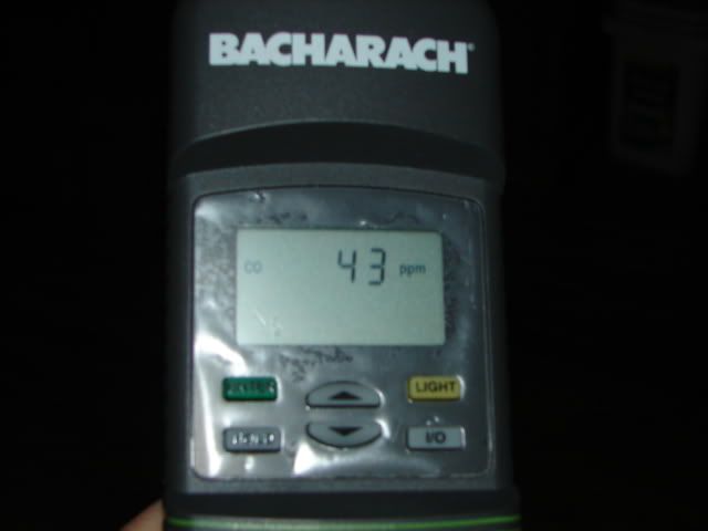

Carbon Monoxide test
this video was NOT taken in the flue, this was in ambient air 3" from the flue pipe - where the flue fits into the collar of the stove.
http://img.photobucket.com/albums/v735/duffy_5669/A2Z%20-%20Nightmares/th_COTest_218TauschmanRd_12_9_08034.jpg
Sorry for the poor lighting … I did not have enough hands to hold the co detector, camera and flashlight. :mrgreen:

Absolutely Marcel, I shot a short movie with the camera, downloaded it with the pictures I took uploaded them all to photobucket and pasted the link in the thread. I did nothing extraordinary … just copy and paste.
Bob That video was taken while running this coal stove. Arrow shows where the majority of the spillage was detected.
What your seeing is the amount of CO in the ambient air in real time. :shock:
Never had a reading like this in ambient space … hell never had a reading that high when I was performing a combustion analysis.
I stopped it at 500 ppm … I didn’t have to see t shoot up to 1000 ppm + to see the problem. Client shut the unit down right away, and was calling the installer and a chimney sweep asap.
reading 18 ft away as soon as I walked in the front door.

Looks like they might have had a little spillage at the thimble too, from the looks of it.
Marcel :D:D
As well as at the name plate Marcel
