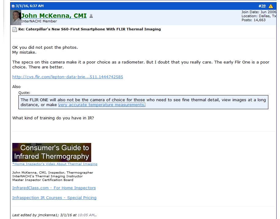

https://www.nachi.org/forum/attachment.php?attachmentid=124882&stc=1&d=1456834110
OK you did not post the photos.
My mistake.
The specs on this camera make it a poor choice as a radiometer. But I doubt that you really care. The early Flir One is a poor choice. There are better.
http://cvs.flir.com/lepton-data-brief?_ga=1.220478360.1093425511.1444742585
Also
What kind of training do you have in IR?
