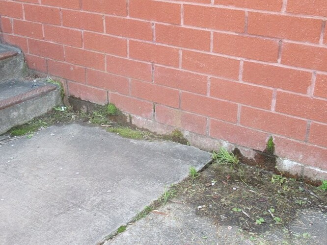

Here is a good one. This is at the base of a built-up slab wall along a sidewalk. Is water seeping from behind or being wicked from a puddle? :thinking: An additional point of interest is that there is a large gap between the stairs and the sidewall.
From my desk it looks like seepage is causing the puddles.
That actually helps the brick dry quicker to the outside. Water from the elements have a clear shot down. That water is coming from behind the brick, God knows where.

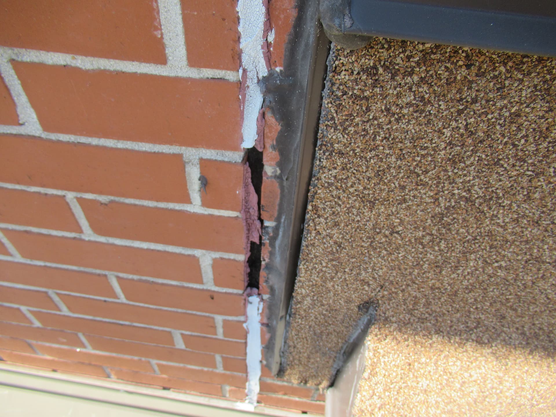

Here are a few anomalies that are contributed to building envelope issues. Of course, fenestration, roof, roof drainage, cladding, and flashing all have to be considered. (and even refrigerant lines :wink: )
Brian, is that a flat roof?
Yes sir, in the areas I have depicted here, it is flat. The building has several flat roof systems- rolled granular asphalt or mineral, ballast EPDM, and tar & gravel (BRU). It is all problematic.
It must be. I would suspect the roof edge, and flashing.
Right! Your intuition and experience are showing. There is a whole case study here on the interconnections of these systems from roof covering, drainage, slope, gutters, flashing etc. and its impact on systems below such as cladding, fenestration, structure and finishes. Here is a quick screen shot from my report, I bet you can see the issues a mile away. (sorry for the poor quality of this image)
