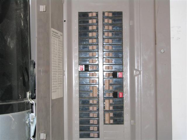

This is the only service panel I could find in the house. It is underground entrance. The main disconnect is out in the alley. Is this right?
See anything wrong here, shouldn’t there be a main disconnect inside at the panel?

The main disconnect is the “service panel.” The other panel (with all of the homes circuit breakers) is an “equipment panel” (sub panel) and should be wired as such (as it appears to be).
This appears to be a set-up similar those found in mobile or manufactured homes.

Any panel “down stream” of the service panel is considered an equipment panel (sub panel). The panel containing the “main disconnect” is typically the service panel.
This main disconnect will shut down power to the entire EP and any subsequent EP's further down stream.
Generally speaking, the first panel in line with the service entrance is the service panel and each panel afterward is an equipment panel (EP) or sub panel (Bob B. doesn't like us to use that term ![icon_wink.gif](upload://ssT9V5t45yjlgXqiFRXL04eXtqw.gif) )

Thanks Jeff, any problem with the main disconnect 150 ft. away from the house, besides not being typical?
Originally Posted By: dvalley
Matt,
You might want to write up the numerous double lugging of neutrals. There's plenty of room for an Electrician to have them separated to one neutral wire per screw.

Ok thanks David. It seems that I have read some where that double lugging of the neutrals isn’t a big deal? Or is it just because there is ample room in this sub pannel? Thanks Matt
Matthew, I agree with all Jeff has said.
Here is the relevant NEC section regarding the service disconnecting means.
Quote:
230.70(A)
(1) Readily Accessible Location.
The service disconnecting means shall be installed at a readily accessible location either outside of a building or structure or inside nearest the point of entrance of the service conductors.
Notice no distance is given for service disconnecting means outside.

Are double lugged neutrals always wrote up as needing to be changed? What if they run out of lugs?

Jeff, regarding subpanels I don't know what to call them, the NEC does not call them anything.
To the NEC a 'subpanel' is treated no differently then an electric range.
Both are 'load side equipment' meaning isolated neutrals.
Quote:
250.142 Use of Grounded Circuit Conductor for Grounding Equipment.
(B) Load-Side Equipment.
Except as permitted in 250.30(A)(1) and 250.32(B), a grounded circuit conductor shall not be used for grounding non?current-carrying metal parts of equipment on the load side of the service disconnecting means........
I always write them up, but they don't always get fixed. If there aren't enough lugs (common in older panels) they can usually buy an extra grounding bar from the manufacturer and move some of the equipment grounds off on it, freeing up more terminals for the neutrals.

With all due respect, I have to question your verbiage. I've never seen panels described as "equipment panels" before. I'm familiar with "Main panels", "distribution panels", the infamous "sub-panel", or, as per the NEC, just plain panelboards (when not used as service equipment).
Mathew...
Mr. Badger just beat me to posting the relevant section...gotta be fast around here! It would be "nice", and also OK, to have a main breaker at the panel, but not required. My understanding of the requirement for a restricted number of throws (main breaker, etc) on an easily accessible service disconnect is that it is more for outside first responders (read firefighters) to be able to quickly disconnect power to the home rather than for the homeowner himself. This particular situation is little different from a main panel in a condo with the service disconnect out at the street or in a mechanical room.
