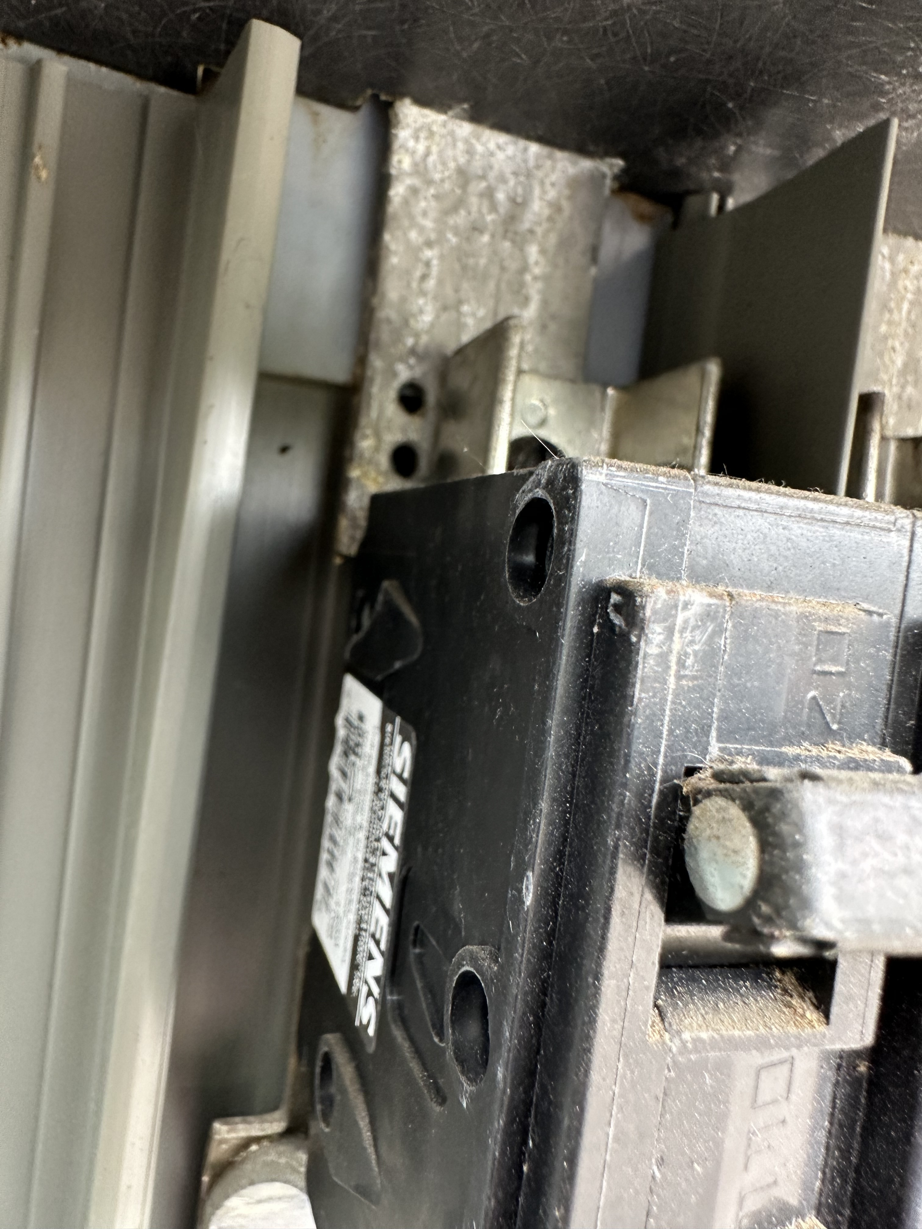

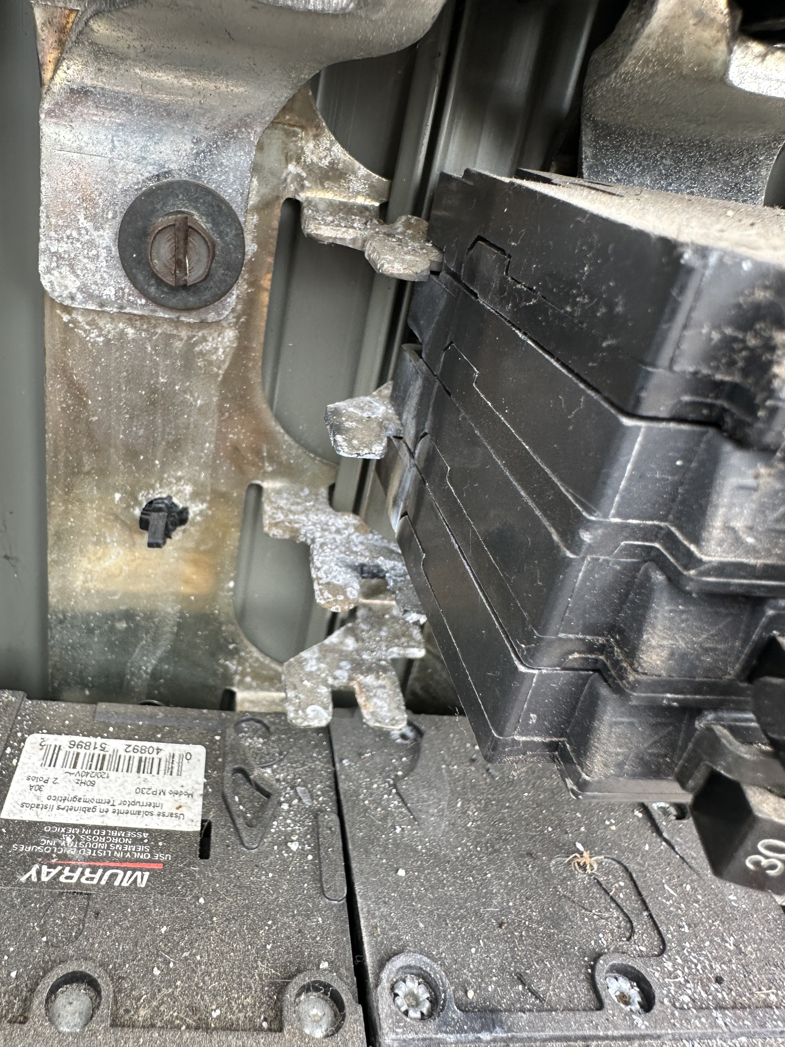

Please correct me if I’m wrong. Is this corrosion? Inspection of electrical panel
It is definitely corroded. From a safety perspective the important part is the contact point between the existing breakers and the bus stabs as to whether or not they’re corroded also. Bus stabs can be cleaned depending on the amount of corrosion present.
That looks more melted to me. But I have only had one cup of coffee.
