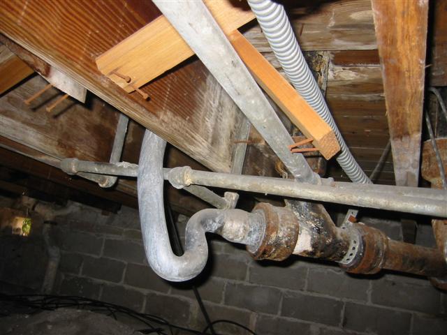

This is my first post to the forum and I’d like to ask for some guidance. Would you write this up as “incomplete” on your report? Some say the cross bridging isn’t necessary, but if it’s present, shouldn’t it be done correctly? This is the first time I’ve seen this where all of the cross bridging was not finished. It looks pretty sloppy, but I haven’t seen any sign of issues above floor level. Thanks in advance, this forum has been a great source of information for a newbie!

Hi to all,
I had the same gig last year with a 1937 hotel in St Petersberg, non of the bridging had ever been fastened all 1500 square feet of it, but then again the crawl disappeared to nothing I don’t see how it could have been done.
Regards
Gerry
Hey Gerry,
'splain the drain…
Gerry;
Like usual, the electricians and plumbers always are ahead of themselves and the carpenters are holding the bag with their work undone.
Marcel
