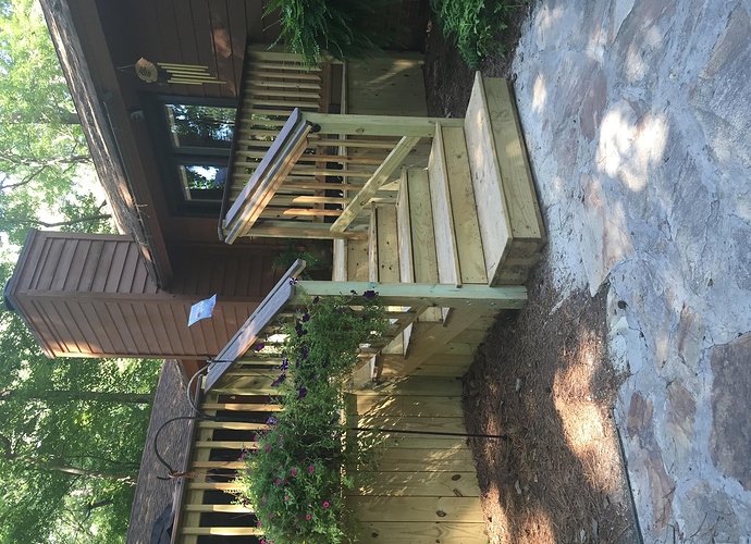

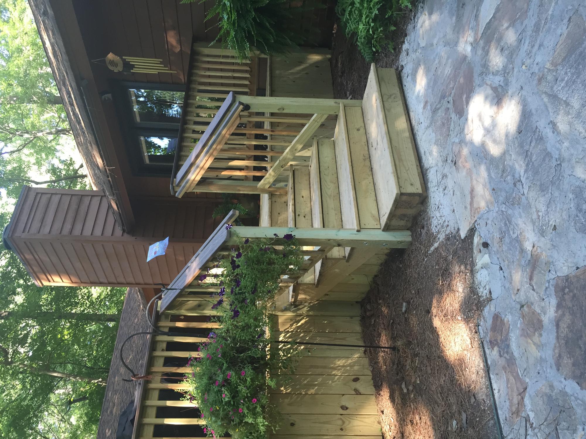

Here is a deck that I inspected, very well designed stairs. One of the few handrails built to code.

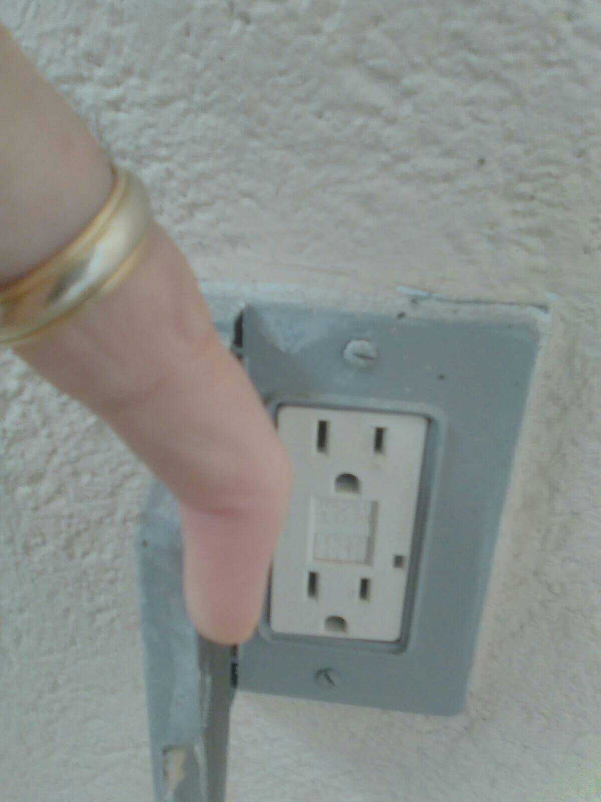

This is an image of a receptacle at a balcony. This outlet has a weatherproof cover. Also is protected with a GFCI breaker.

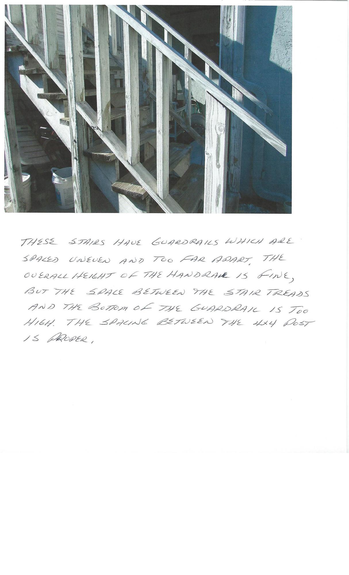

These stairs have guardrails which are spaced uneven and too far apart. The overall height of the handrail is fine, but the space between the stair treads and the bottom of the guardrail is too high. The spacing between the 4 x 4 post is proper.

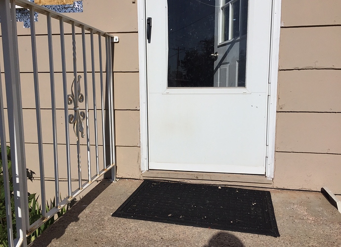

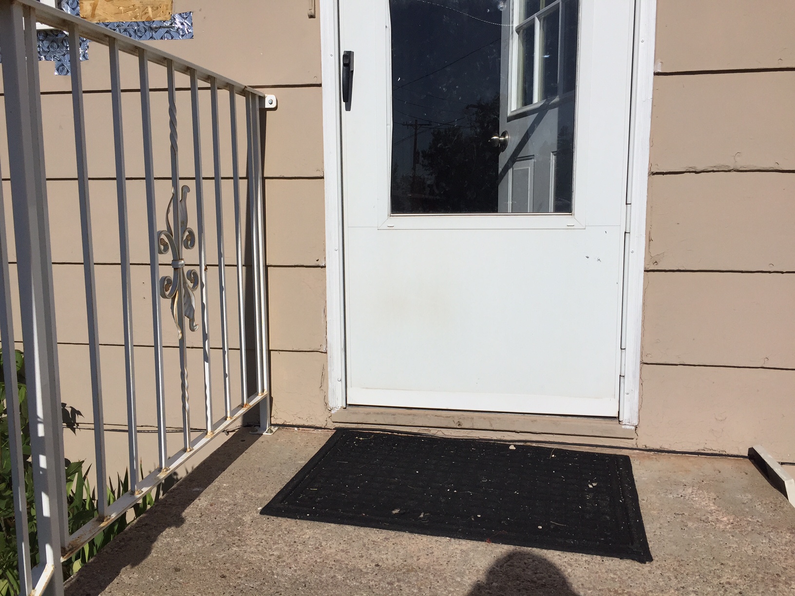

The attached picture shows the lack of an exterior outlet at the rear of this home. This home was built in 1961, well before code required an outlet at the front and rear of the home and no more than 6.5 feet off the ground. I would recommend installing a GFCI protected outlet with a weather guard be installed at the front and rear of the home, to potentially eliminate the homeowner using an extension cord.

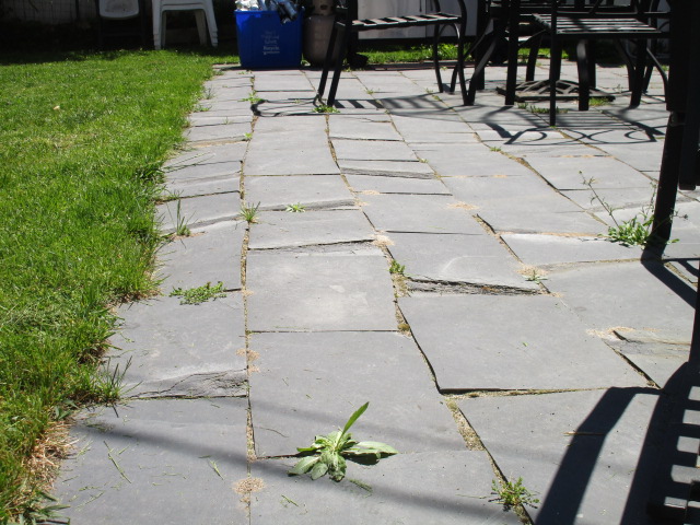

Patio inspection:
Cracks, holes, settlement, heaving and/or deterioration resulting
in trip hazards found in the patio. Also the problems of the heaving in the patio can wick moisture toward the foundation. For safety reasons, I recommend that a qualified contractor repair as necessary to eliminate trip hazards.
Patio Inspection:
The patio with cracks, holes, settlement, heaving and/or deteriorating results in trip hazards. Also problems of the heaving of the patio can wick moisture toward the foundation. For safety reasons, I recommend that a qualified contractor repair as necessary to eliminate trip hazards.

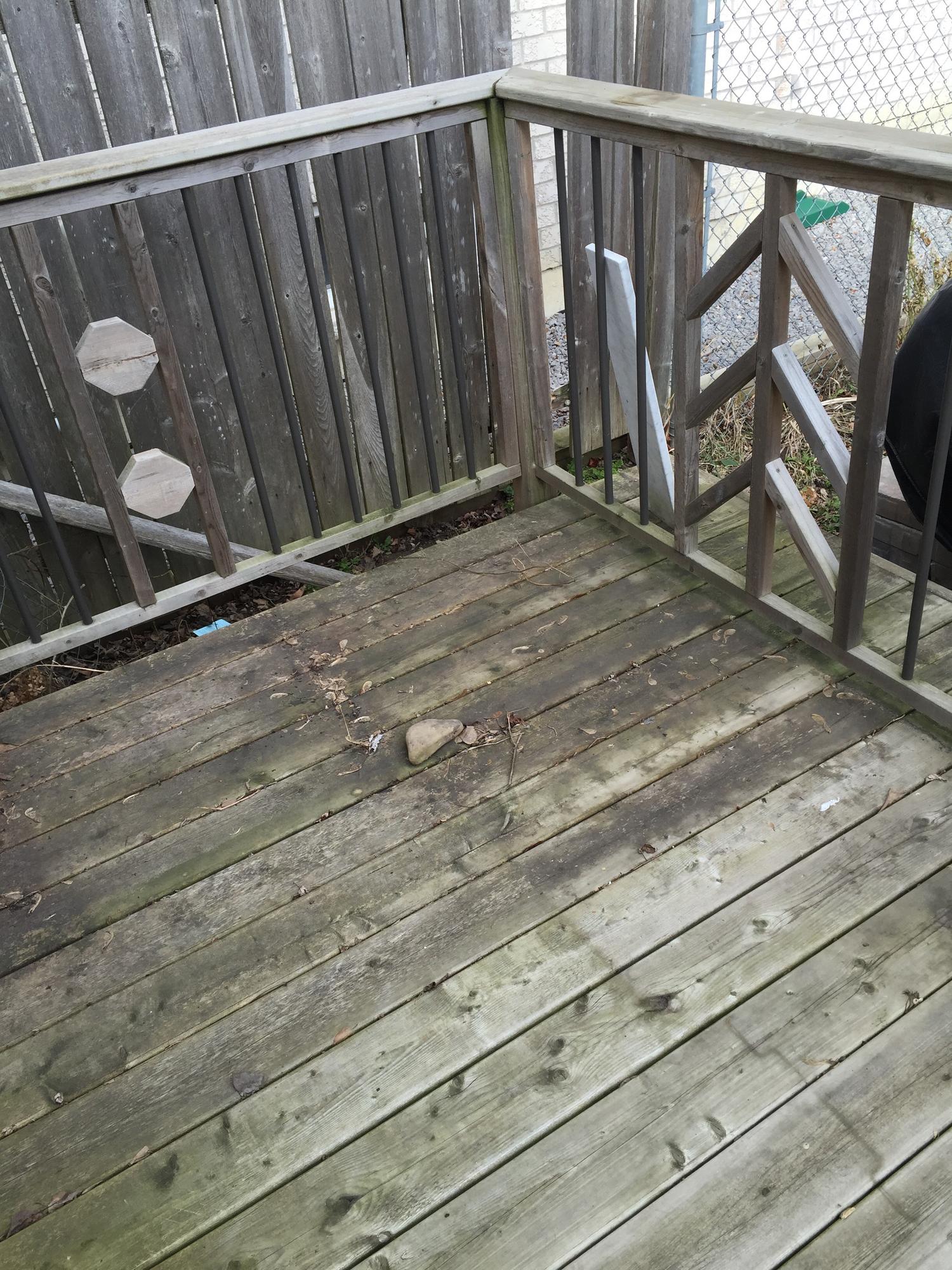

This is a photo of a section of an older wooden deck with perimeter railing at the rear of a residential home. Metal & wooden balusters were used however one concern is that the decorative detailing in two areas may be climbable by children. The decking is of adequate length although spacing may be inadequate for water drainage in some areas. There was a large tree providing shade over this area which may also be contributing to the apparent moisture & discolouration of the decking.

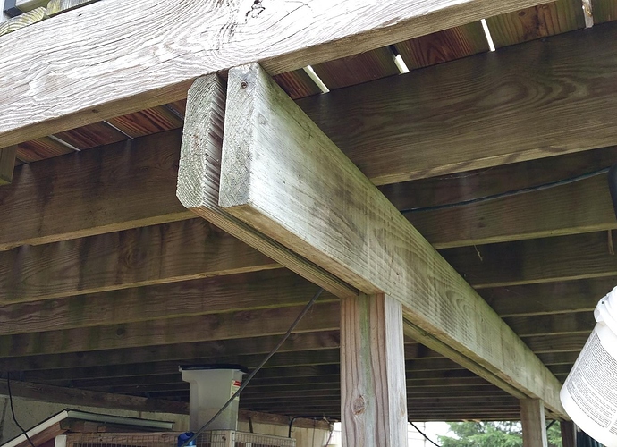

Deck: Noted that the girder was not attached properly. Noted that some of the spindles are spaced to far apart exceeding the 4-inch rule. Noted that a large tree had branches capable of contacting the deck and causing damage. Noted 4x4s used where they should be 6x6 and no cross bracing was used.
