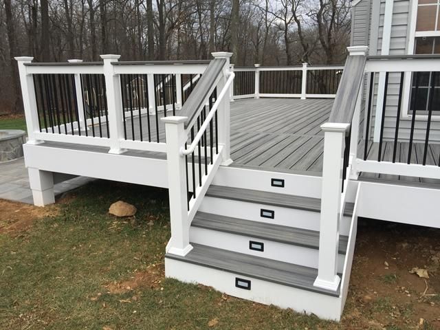

Inspection & Writing Assignment:
This picture shows an often overlooked safety feature on outside deck stairs, lighting that covers the entire area. In this instance, the lighting is combined with closed risers on the stairs, ensuring that each tread is properly lit, with no possible shadows as would be seen with overhead lighting, and the closed risers automatically fulfill the 4" maximum gap requirement.
