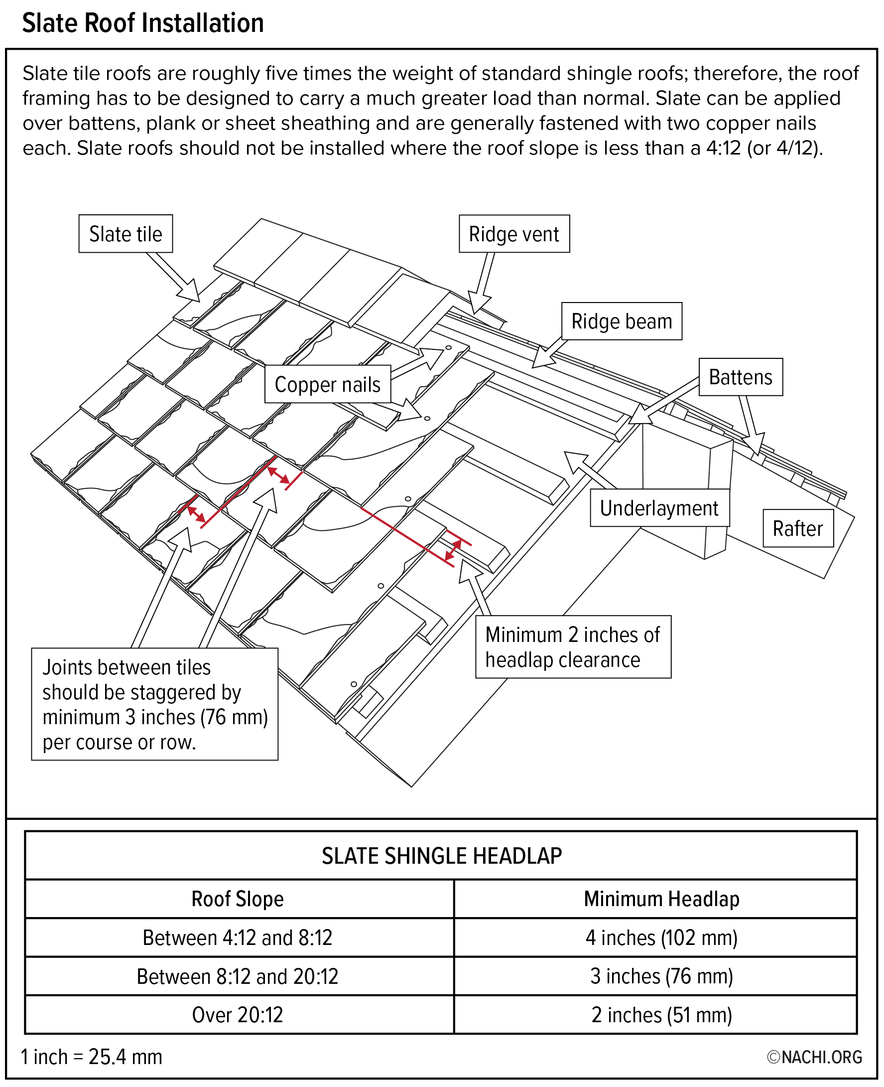

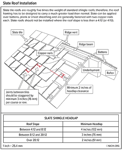

Draft Image: Slate Roof Installation
I’m posting this image as a draft before finalizing. I would like to hear any valuable feedback from the forum. Thank you!
These are really good.
great info thanks for posting!
Afternoon, Zac. Hope to find you well and in good spirits today.
Very nice drafting an illustration exercise.
Looks great Zac.
