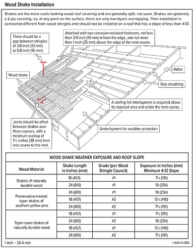

Draft image: Wood Shake Installation
I’m posting this image as a draft before finalizing. I would like to hear any valuable feedback from the forum. Thank you!
Thank you.
Keep up the great work, Zac!
