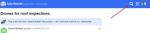

Hi Gerard, welcome. You may wish to use the search feature on this site because a ton of drone information has already been discussed.
