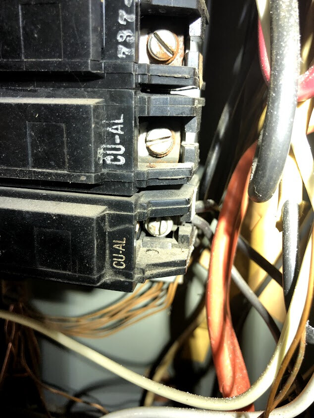

Newby here. 4 pt inspection. 1964 home. I’ve not run across this type of older panel so far. I do have a guy that helps me with electrical but would like more input please. How do I determine amperage, is Cu-Al ok, the cloth covered wiring, those handles? Is insurance going to threaten to drop client unless the update?

There are fuses behind the pullout.
I don’t see aluminum. Probably tinned copper.

Hard to make out if those are cloth or cloth jacketed wires pic #1.
I’m leaning to cloth.
Most likely built in the 50’s to mid 60’s.

Most important is the wire, if it’s true cloth chances are the owner in sunk
May find someone to accept fuses.

Can’t help you with the Florida 4-Pt thing, but if a normal inspection in my area, I would call out that panel as being outdated and rusted, and in need of upgrade. Wiring should also be evaluated by Electrician and likely upgraded, even if only within 12 feet of the panel as some areas require as a minimum.

Most of the aluminum wiring I’ve ever inspected had thermoplastic insulation not cloth covered insulation. There is a lot to know when inspecting this installation, it’s doubtful that I would check the Satisfactory Checkbox in the Electrical Section on the Four Point Form. Most likely repairs by a licensed electrician will be required, and I would not speculate exactly what repair/replacement is required either.
Photo #1 has conductors that are rubber insulated, tinned copper. Regarding the service ampacity you would need to pull the fuse holder/disconnect to see what size fuses are in there.
