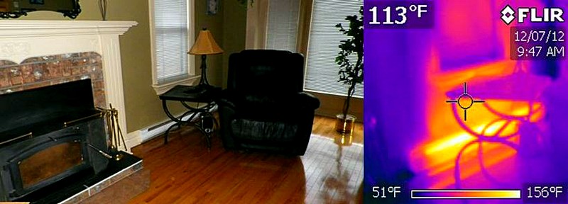

I have the understanding that an electric baseboard heater should not attain a temp above about 165 degrees. Is that a code issue, a manuf. stat, a rule of thumb? I have seen it before on this board, but can’t find it. I run into many that will reach a temp of 190-205. Way too hot for me. Any help?

Bob - I understand and agree with all that. But where is the data and what constitutes a temp too high. Or am I wrong about the temp?
http://subject2homeinspections.com/index.php/about-the-house/item/all-about-electric-baseboard-heaters
