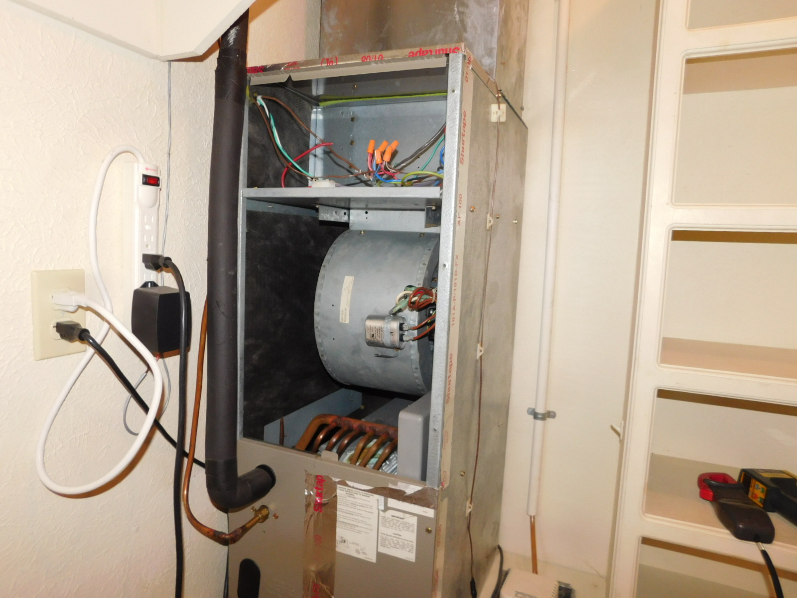

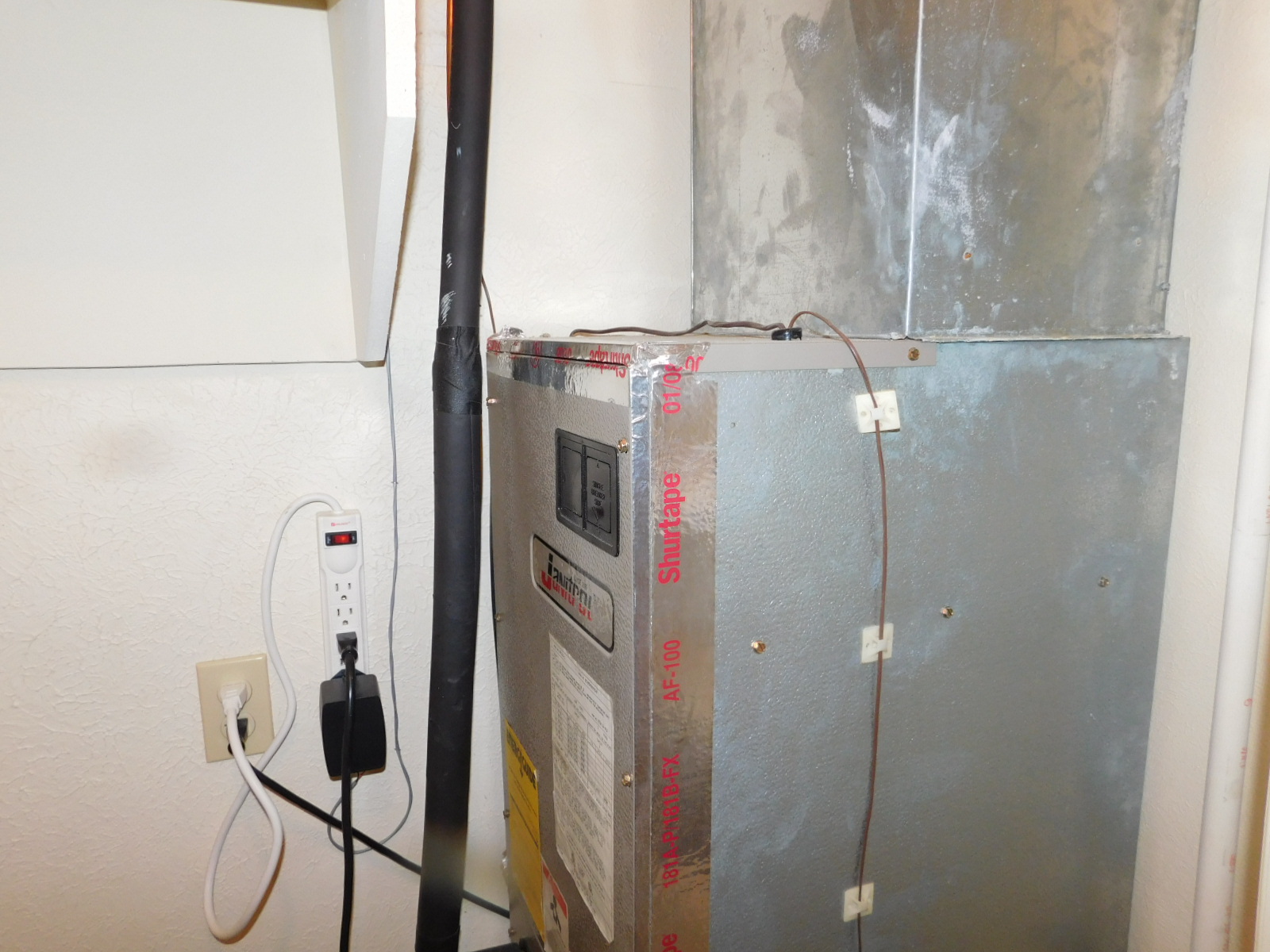

How do you know how many KW a electric furnace uses if you don’t look by removing the front cover. How many KW does the furnace in the PIC have, this question should be for the newbies.

0 KW…

I just try to generate the thought process:D:D The simple things are the most overlooked. I would like to see a report that stated the upstairs furnace did not operate in the heating mode;-) and that could of easily happened by the guys that just operate a system from its thermostat. Its called getting egg on your face when you over look something like this
They are only used for aux heat here. That was the main heat source for that that house?

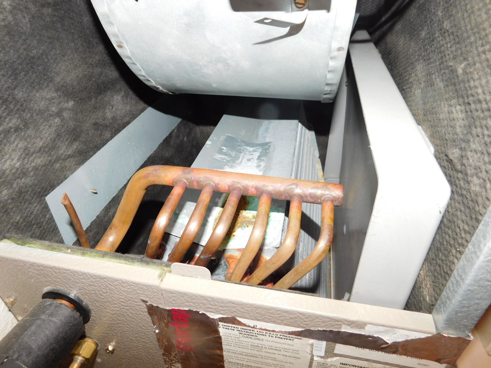

No it was for cooling only for the upstairs There was a 5 ton split system and gas furnace for down stairs that was providing heat for the upstairs just would not cool the upstairs so this little AHU with no heat strips was installed

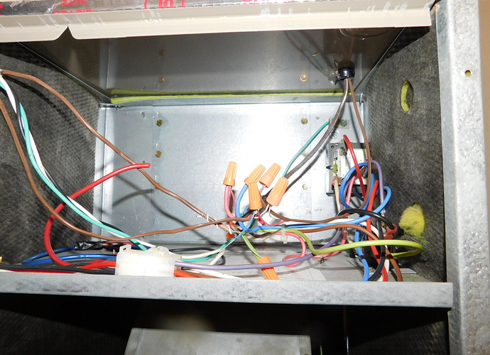

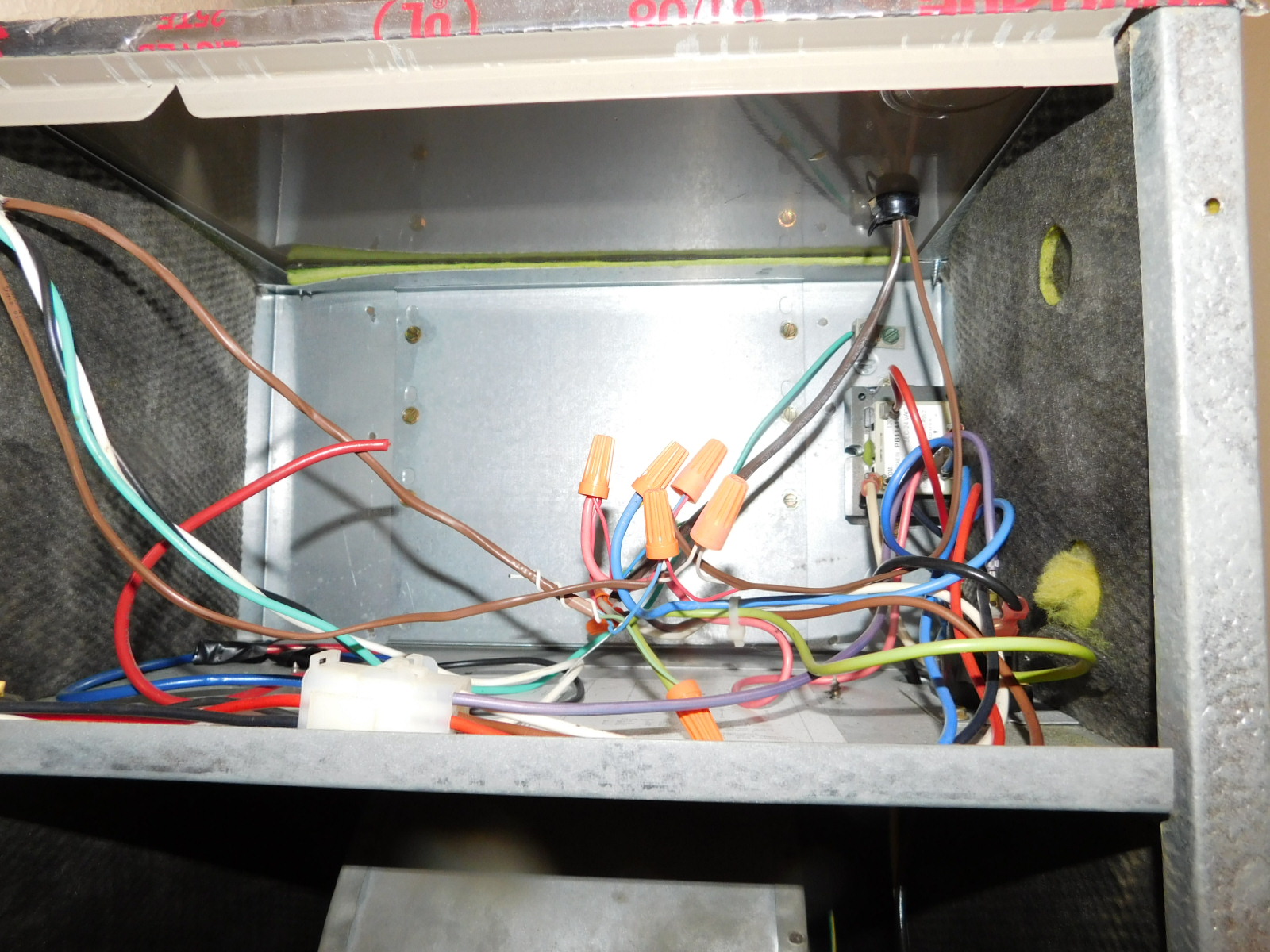

Air Handler … If I looked at it right, no 240v breaker / 120v power to unit.
No heat strips, etc, etc
That is correct but how many have over looked that it was as obvious as the nose on your face;-)
