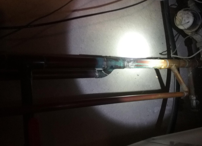

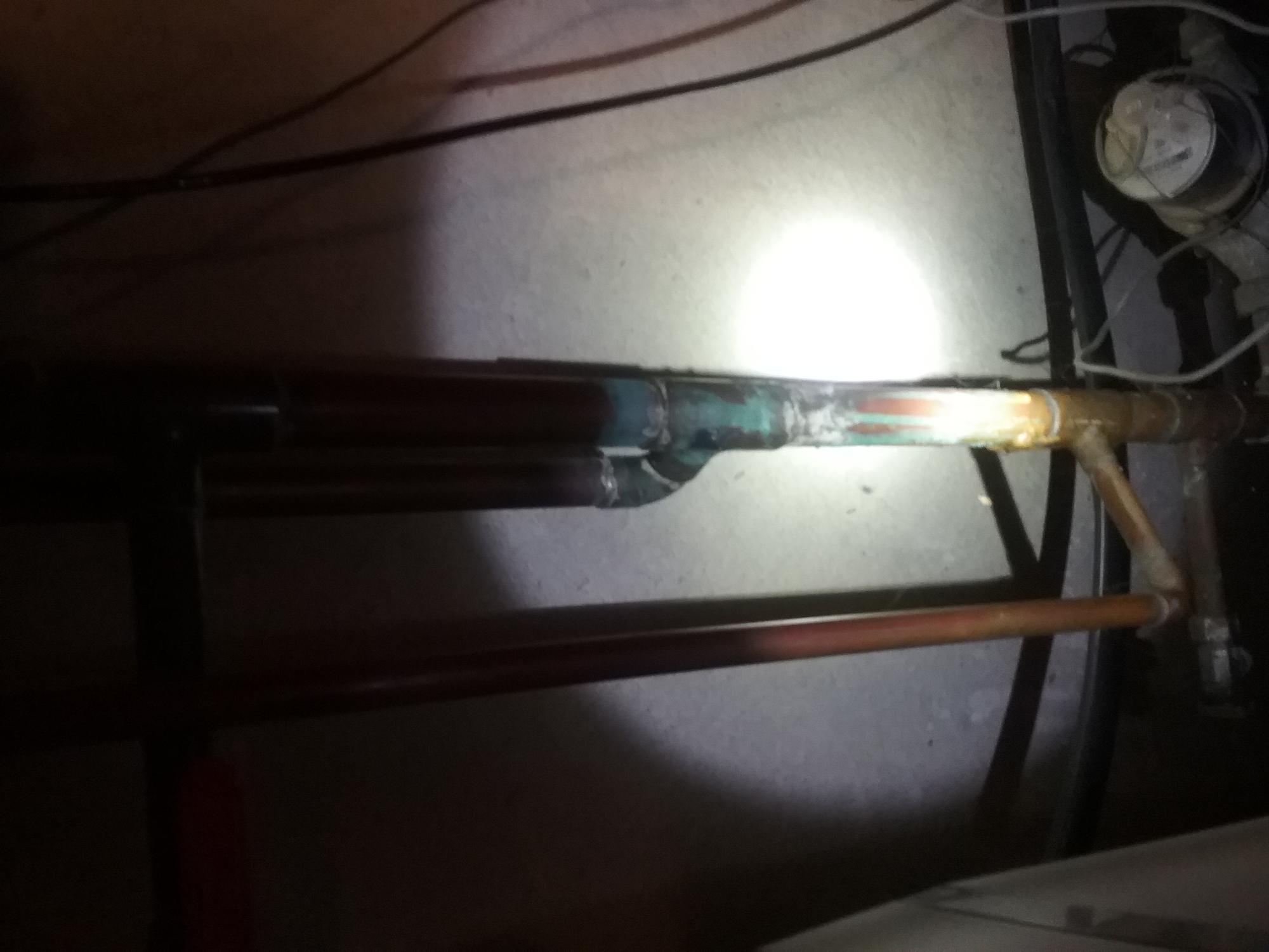

Can anyone explain what would cause the electrolysis between two similar copper pipes, at couplings and elbows.
Thank you
(Roy D. Cooke, Sr) #2
Looks like the solder flux was not cleaned of properly when the job was finished .
