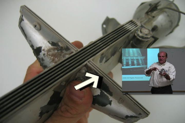

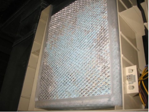

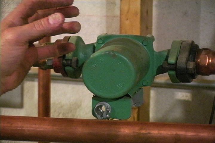

What is the HVAC component? What’s its function? What condition would make this component a defect or safety hazard? How would its condition affect the entire HVAC system’s performance or safety?

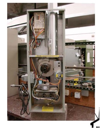

Describe this type of system? What component could indicate to you whether this system is installed upside down?

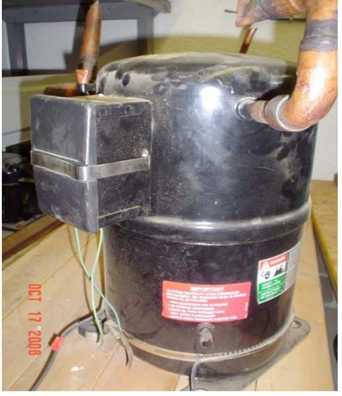

Ok I am back caught up until tomorrow morning. It appears that Ben has added some advertising since my last visit/post. In my last post we talked about switches caps and the low voltage circuit starting the compressor.
Lets continue with the basic refrigerant cycle starting with the smaller of the two lines extending out of the compressor this is the hot gas discharge high pressure vapor line (250) PSIG that is discharged into the condenser coils. One of the heat transfers occurs at this point in time the higher temp of the hot gas vapor transfers its temp to the air moving across the condenser fins thus condensing the hot gas to a high pressure liquid. This high pressure liquid (250) PSIG exits the condenser and becomes the high pressure liquid line that you observe on the exterior of the unit and travels to the A-coil. This high pressure liquid can not enter the A-coil at 250 psig so we have to add a metering device to control the amount of refrigerant allowed into the A-coil. The metering device is the dividing line between high pressure and the low pressure side of the system. Once the refrigerant is metered into the A-coil as a liquid this liquid refrigerant flashes back into a vapor at approximately 65 PSIG within the A-coil. This is where the next heat transfer occurs. The refrigerant within the A-coil is colder than the return air temp thus the heat transfer from 75 degree return air temp to the refrigerant temp within the A-coil approxinmately 50 to 55 degrees keeping in mind that heat is always transfered from a higher temp to a colder temp. The large line protruding from the A-coil and visible at the condensing unit is the suction line or refered to as the low side. The compressor is the dividing line between high and low pressure at the exterior condensing unit. The compressor draws the low pressure vapor from the A-coil and starts the cycle all over again.
Another item to remember is that some oil from within the compressor crank case always travels with the refrigerant through out the system but should also return to the compressor if the lines are installed properly. Anytime the exterior condensing unit is installed higher in elevation than the A-coil. (Examples) 1. Roof top unit with the A-coil on the first level. 2. Condensing unit ground level and the A-coil in the basement. It is good engineering practice to install a P-trap in the refrigerant suction line on the exterior side of the A-coil box this ensures that the oil is returned to the compressor and does not become trapped within the A-coil decreasing efficiency of the coil. An A-coil that has a good amount of oil trapped within does not have the proper amount of refrigerant within the coil to have good heat transfer.
One last statement this evening for those that think if you operate an A/C unit when the ambient temp is below 60 degrees that the unit is going to disappear in a cloud of smoke and you will have to buy a new unit. Fear not these units are tougher than most can imagine especially now with scroll type compressors being used. No I am not telling you to operate the unit when the outside ambient is below 60 degrees just follow your SOP. But I can tell you that if playing with the thermostat you accidently turn the A/C on it will not make it disappear;-). Questions please

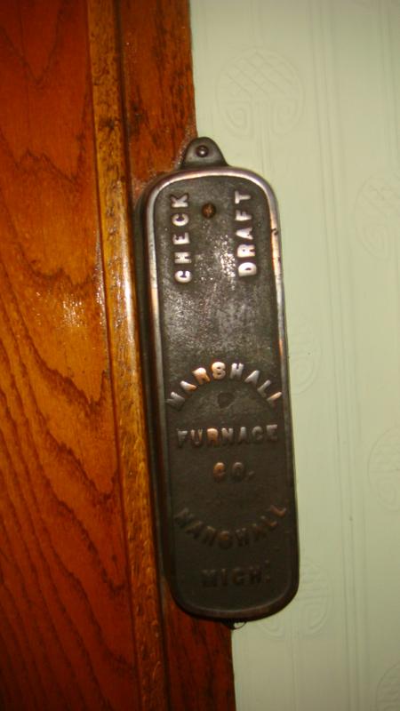

Charley, do you think some might want to know how this draft check for the old furnace worked? I know I would.:slight_smile: It was located next to the thermostat in the dining room.
Good question but it appears to be before my time if I was to take a wild guess I would say some sort of counter balance weight to see if the barometric damper was operational just a guess???
