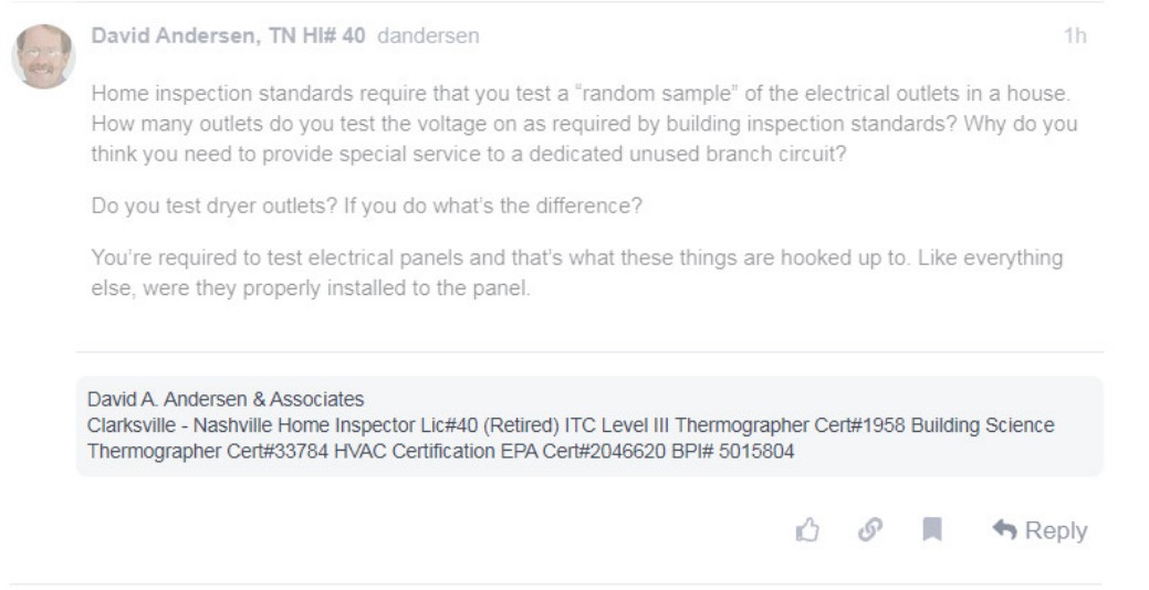

Can’t imagine why David’s post was flagged. This whole discussion lacks any basic information about EV charging, without which you SHOULD NOT be attempting to test. There are several different approaches to EV charging and it should ALWAYS be deferred to a specialist. There is simply no way you could reliably determine if a EV charging system installation is adequate or functional.
I disagree. There are several standards for the plug at the end of an EV charger, but the important bits to safety and inspection are all basic volts, amps and quality of wiring.
So you’re really only testing the branch circuit not the actual charger itself.
The chargers self test themselves.
