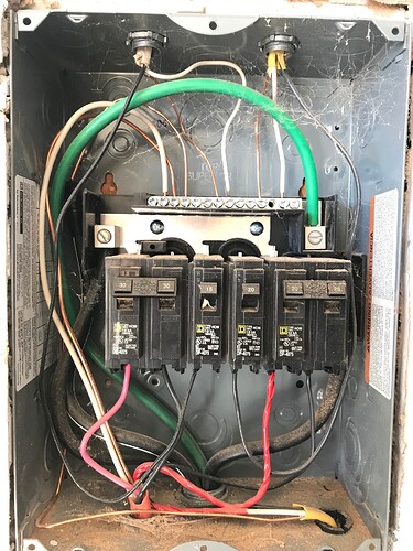

Sorry for the delay. Here are photos of the panels with covers removed. I am just now learning about the electrical component via internachi, but after removing the garage panel I noticed something strange: one of the feeder lines (I think it would be the neutral line) is not attached to anything - it has elec. tape on the end of it. You can see it in the top left corner in a shadow. Shouldn’t this be connected to the neutral bus? And shouldn’t there be a separate bus for the ground?

From these pictures, you have 2 separate feeds from the meter. One to the house and one to the garage. This looks like the garage panel and note the lug on the right that was hidden by the installed breakers.
Also, the neutral is not properly identified.
