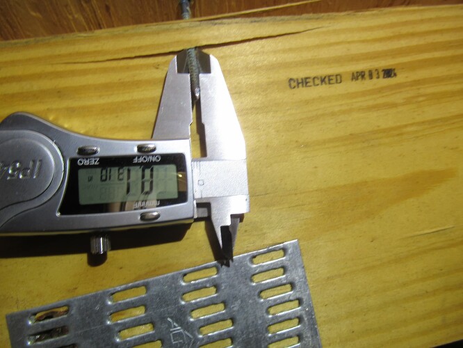

In mid 2019 when the FBC 2020 draft was first released I noticed the new requirements for roof sheathing thickness (19/32 40/20 Span Rated instead of 15/32" sheathing) and attachments I immediately crafted a narrative for future use because I thought it would be widespread issue. Turned out I didn’t find the first one until almost 3 years later (a couple of months ago). As of today I have now found 3 homes with the wrong thickness sheathing 2 back to back last week. One of them wasn’t even 15/32" .:man_shrugging:

.Now confirmed in 6 different counties in SWFL, incorrect roof sheathing and/or sheathing fasteners. Collier, Lee, Charlotte, Sarasota, Manatee and Hillsborough. Wrong sheathing and/or fasteners used to secure roof sheathing.
We can add Pinellas County to the list now too.

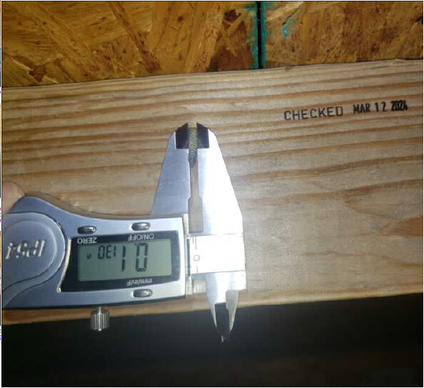

Found another good one today… we’re up to 14 out of over 220 in seven different counties. Not surprisingly almost half of the homes with the correct sheathing and fasteners are in the same neighborhood.

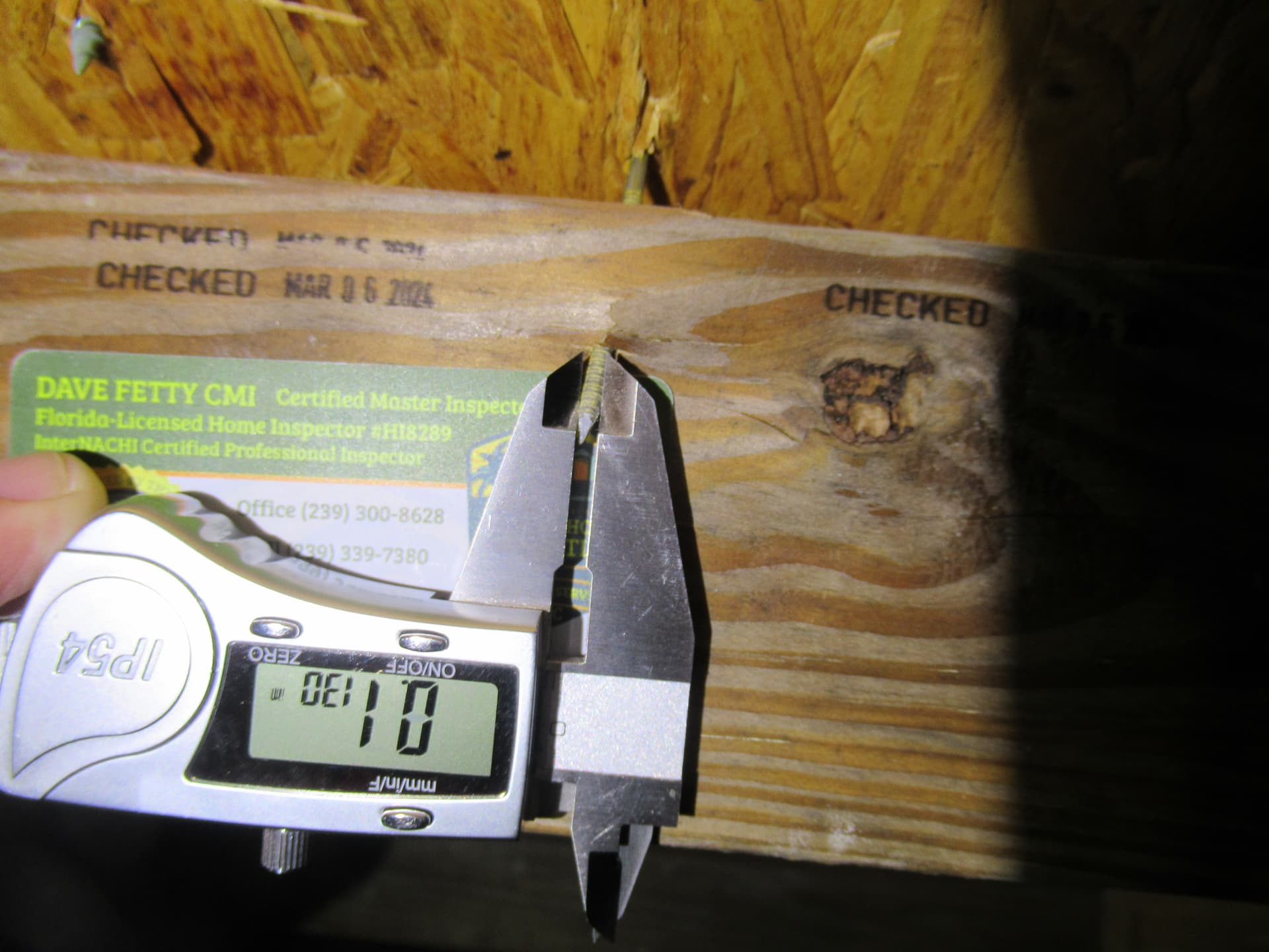

This one mostly the correct fasteners installed, but still had a significant area incorrect fasteners observed.
More fun stuff…
The trend continues…
This one is a double… Concrete Roof tile installed on OSB and the wrong nails used to fasten the sheathing.
Another double last week. :roll_eyes: :unamused:
And so it continues.

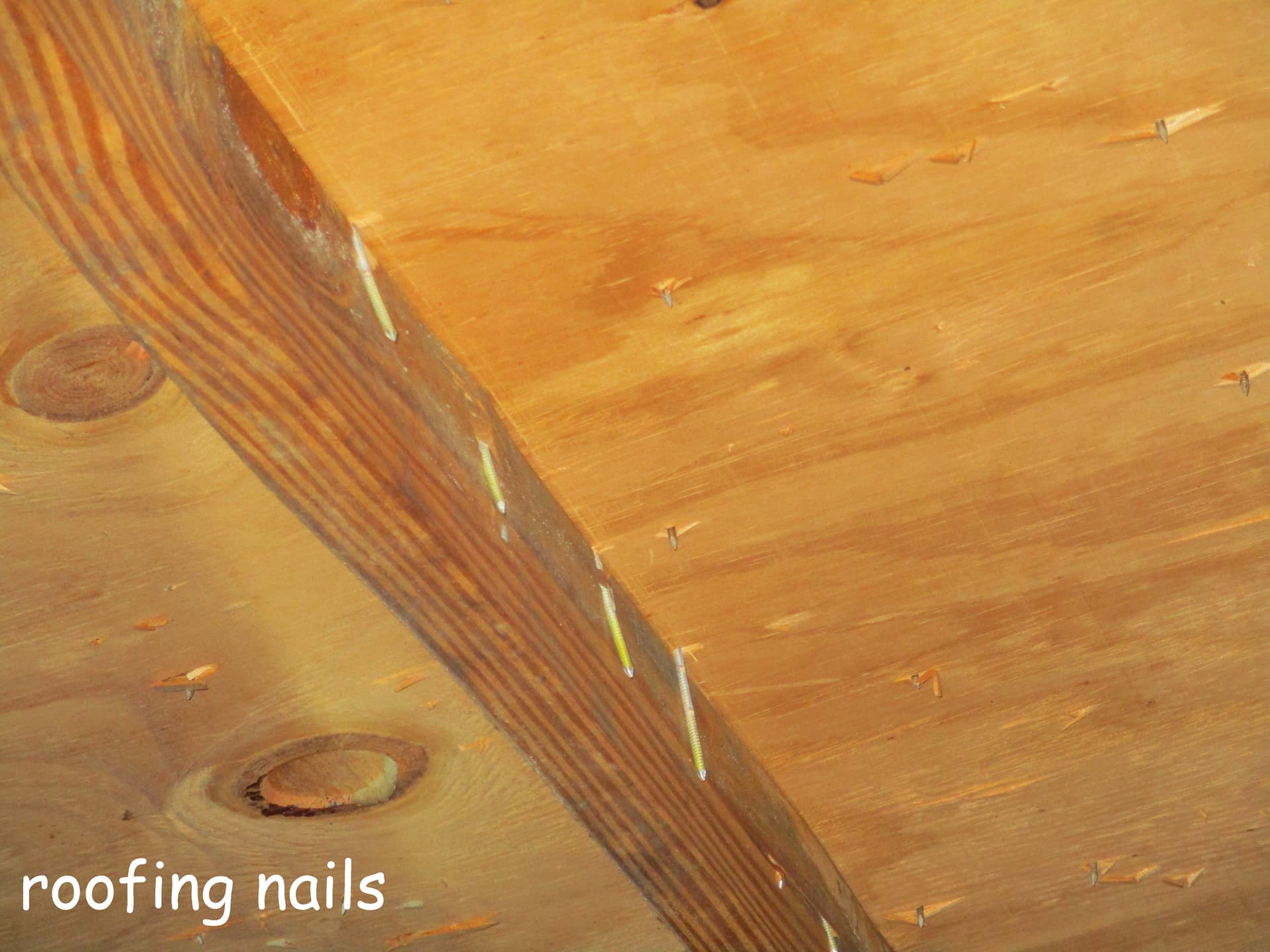

As to the nails, paraphrasing, “The nails shall be installed into the framing members”…not thin air…

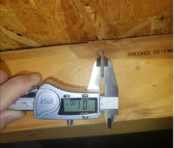

Ran into this on a 3 month old re-roof last week

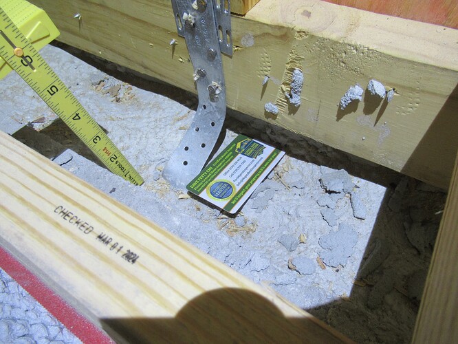

I’ve encountered new builds with this condition throughout the attic. Hundreds of shiners.
I watched one builder rep pull out his tape measure and tell the home owner “this is the difference between the nails” referring to the 1/8" length.
That same builder rep produced a document claiming OSB is “fine”… it was from another state.
