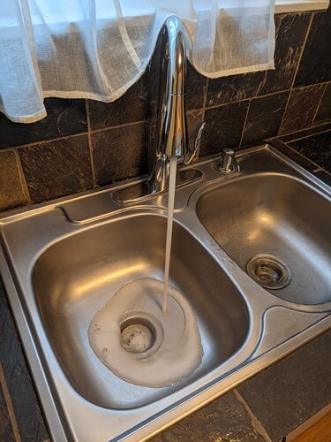

Doing the inspection today and noticed that the hot water causes a lot of bubbles there’s faint smell from the hot water but nothing from the cold water kind of almost maybe like a cleaner but I can’t tell can’t figure out what the smell is. The cold water runs crystal clear. Each faucet is that way what the heck causes that?
Both the hot and cold water lines appear to be CPVC there’s no expansion tank on the water heater but I don’t see an obvious difference between the lines so far.
Could be air… fill up a clear glass with hot water and let it stand for a minute. If there is no more foam, it’s air. Otherwise it’s some sort of substance.
I just did that and the bubbles went away so looks like it’s air but why is there a smell difference. It’s not a strong smell but there’s definitely a difference between hot and cold

The smell is either from the gas that’s coming out of the water when heated (thus the foaming/bubbles) or from the tank itself. What does it smell like? Take a sample of cold water and boil it… if you get the same smell as from the hot water, the smell is from the dissolved gas in the water. If there is no smell after you boil it, then it’s the water heater adding it.

You have just discovered why the hot water has air in it. The water in the unused water heater will become saturated with air and will become apparent as it passes the aerator in a faucet. It’s a non issue.

I had this exact issue (the photo was precisely the same). I found the problem to be related to the Sacrificial Magnesium Anode that came with the new electric water heater. Apparently, that’s not recommended for hard water, like mine. I did a bit of online research, and discovered that when the Magnesium oxidizes (as it is intended to), it can release hydrogen into the water, causing the foamy or frothy water.
The good news is that this appears to happen only for a couple of days after the new electric water heater is installed. My guess is that once the Anode rod starts doing its job and corroding, it quickly reaches a state where it’s not quite so reactive.
Anyway, I’d encourage anyone to correct me if I’m wrong, but this is what I found and I thought it might be useful to any readers.
