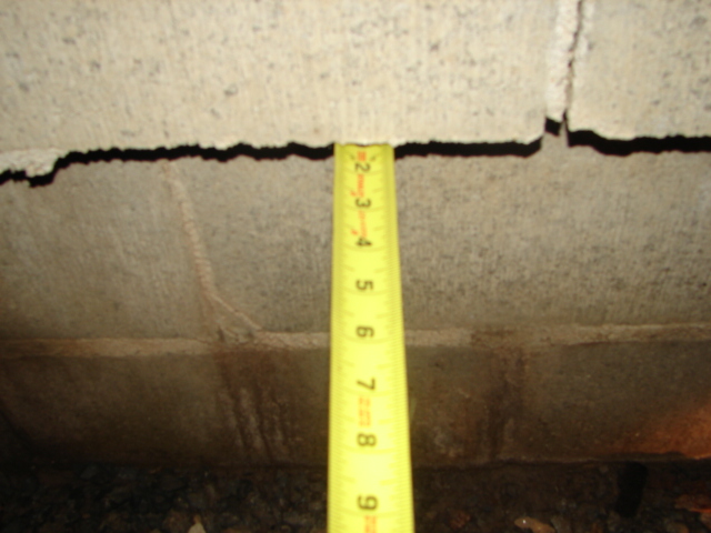

Here`s vertical hairline crack in poured wall, cost $850. http://www.snapfish.com/thumbnailshare/AlbumID=228621104/a=122238283_111847456/t_=122238283
Explained to him that if HE wanted, he could TRY chiseling crack and applying hyd cement OR, he could call those who do injections.Or i offered to talk him through digging it himself with buddies,have and will do this for anyone. If ya look, the grade is sloped away,see last 2 pics.
