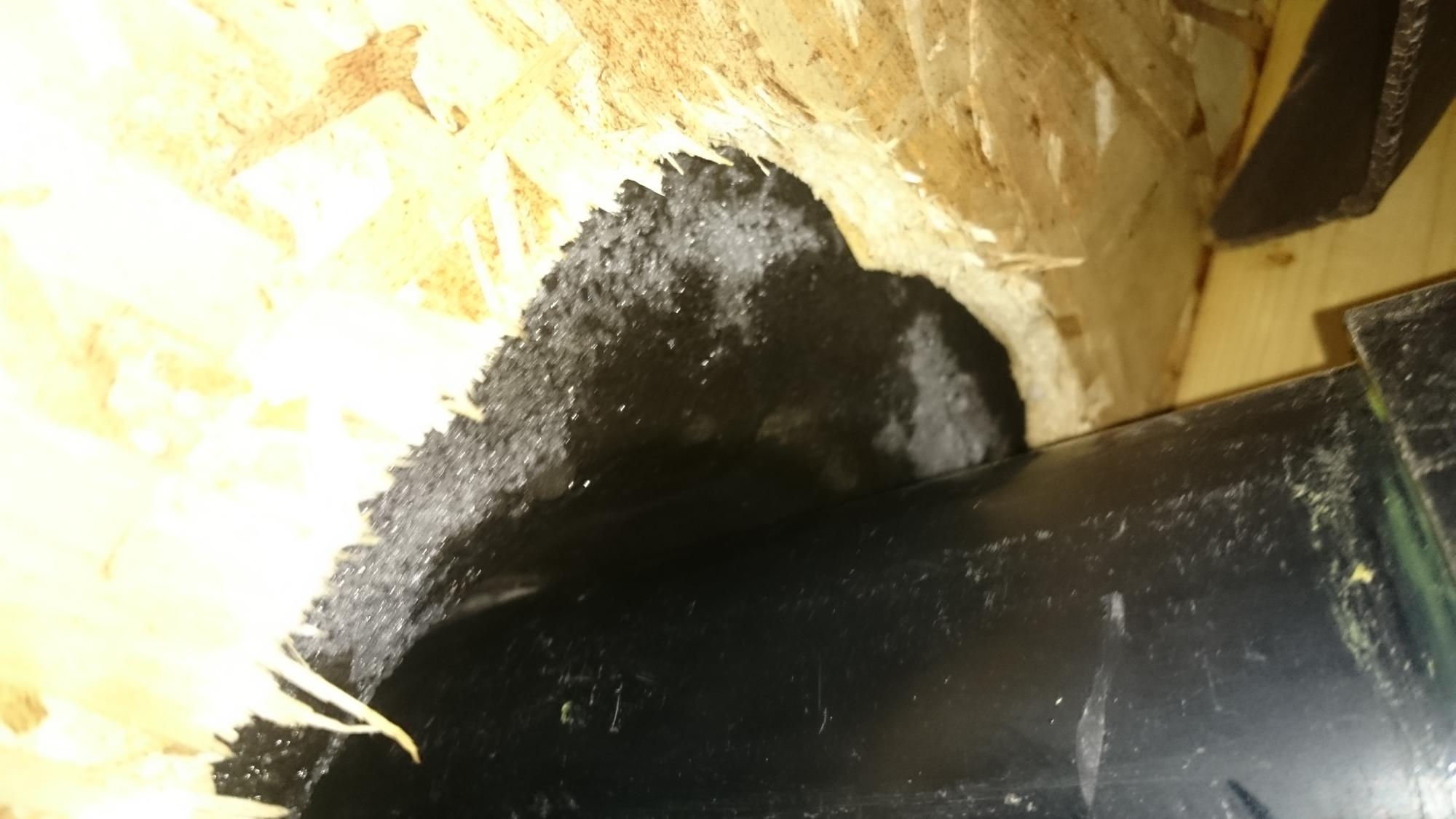

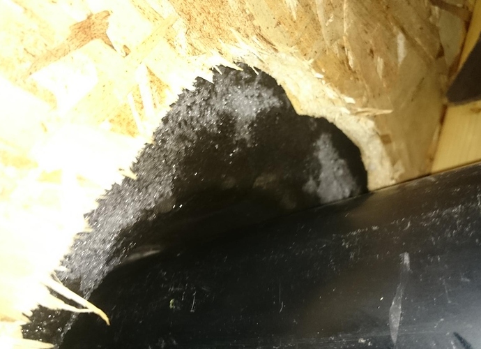

I’ve come across an attic with a localized moisture build up spot. In troubleshooting the stain on ceiling two floors below I traced it up along the plumbing vent pipe to the roof as likely travel path for water coming down. Near the vent pipe in attick I noted staining on roof truss and about a foot away the insulation was about 6-12" less in a 1’ circle than the rest of the attic (blown in insulation over batting in all of attic, but blown in missing here). Possible that refilling in this void in insulation will cure the centralized condensation issue? Note client said stain appeared right after weather warmed from -35 C to -15C. Roof still covered in snow. No staining on sheething, but frost build up noted around underside of the seal around plumbing vent through sheething.

Moisture escape is pretty much a given is it not? Pretty much impossible to have a perfect seal, especially in areas where you have penetrations like plumbing stacks.
