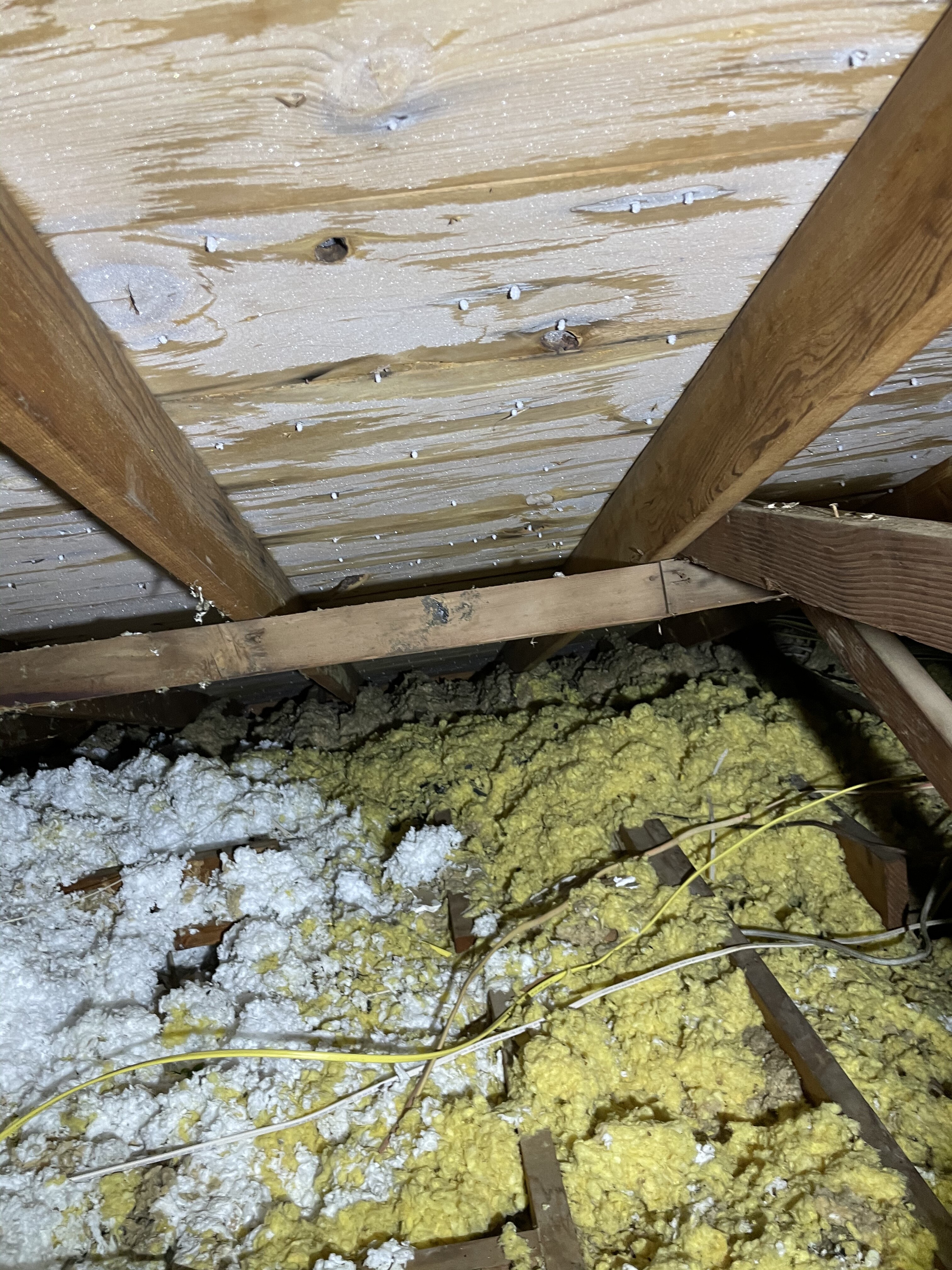

How would you guys write this with frost in the attic? Frost
We’re you able to identify the source of the warm moist air?
Is there adequate attic vents? Ever see attic vents closed for the winter, when they are needed most?
Then look for the source of indoor air below entering the attic. Bath vents, ceiling electrical, walls open at the top plate, leaking attic access…
I’m in Minnesota and it was -26 F. this morning in my area. Many, if not most attics will have some frost in these conditions. Your area may be different.
Insufficient insulation with heat escaping from house to attic and cold cold air produce frost.

When you get up in the attic and preferably away from the light from the access area, shut your flashlight off. Look for light at the lower edge of the roof and at the ridge. Gable end vents are acceptable but not always adequate.
That will tell a lot.
Frost & ice can form in attics when warm, humid air accumulates and condenses on the underside of the roof sheathing.
The sheathing looks stable. When a little bit of frost forms, as in your image, this can occur after really low nighttime temperatures. By the looks of the plywood sheathing, it does not appear to be a big concern. The frost, a phase change from water vapor, a gas, to ice will likely melt, then evaporate so that the wood can dry.
The lumber looks clean.
Observation: Thin lay of Frost covering various areas of the roof plywood roof deck sheathing and fasteners.
Unable to observe daylight at the eaves.
Suspect: Insufficient attic ventilation.
Insufficient insulation. Uneven blanket.
Recommend: A licensed insulation contractor install additional insulation to meet the climate zone you are in to improve overall occupant comfort and decrease energy consumption.
Recommend: A licensed ventilation contractor adequately ventilate the attic.
Any icicles at the eave?
I would not even discuss it considering the conditions are indicative for your geographic region.
It is not a defect when it is expected to occur.

Thank you for the information. I didn’t see any ice. This is the first time in our area we’ve have seen temps this low in 33 years. The roof had about 6 inches of snow on.
I haven’t seen this before during the winter. I just inspected a home(today) that was 10 years old with the same thing. It looks like we’re not adding enough insulation for this kind of cold.(wind chill was -25 with a temp of -4) I will make a note to my client.

I would note the occurrence of frost during you inspection and recommend monitoring the attic during above average cold days. I bring sensitive measurement equipment with me like hygrometers or HVAC temperature relative humidity meters and measure exterior and interior spaces continuously. Once there is an anomaly in any level, readings are photographed and placed in reports.
