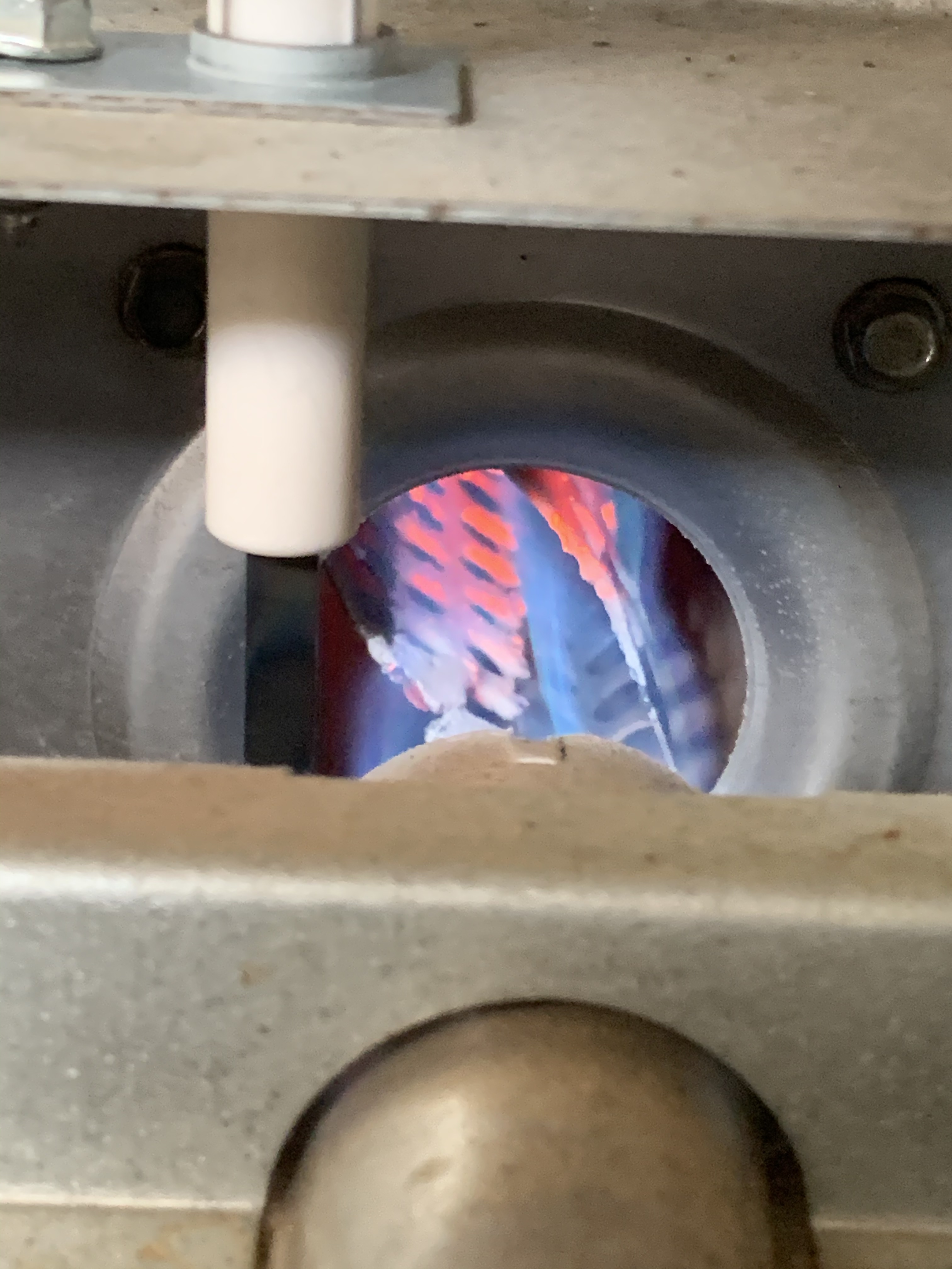

Inspecting a newer furnace there was white deposits on a metal grate Inside the burner tubes. When the furnace was on the white substance on the metal grate would light up red hot
Any idea what the white deposits are? And what the grate is for?
displaced nox emission reducers
if in a low or ultra low nox region advise repair
if not advise repair so warranty stays in tact & mfr doesn’t have an escape clause due to pre-damaged unit
The metal insert causes turbulence to increase residency to improve efficiency. The white is probably zinc oxide.
